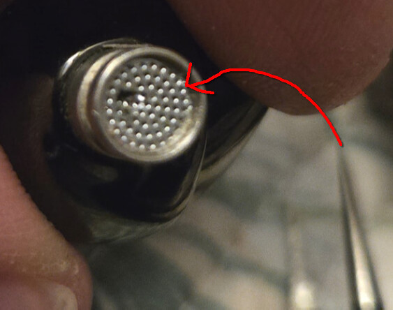

oof, as the others mentioned you should replace it. Take it out and see if there is another filter or not under it acting as a damper, if its JUST that metal filter then you can easily replace it with the same or similar enough thing from aliexpress as that just looks like a non-dampening filter meant for debris protection.
https://www.aliexpress.com/item/1005011582508555.html
Like this. If you have a caliper then measure it and see what size it is.
Thanks dude, and thankfully it’s just the grill :sweat_smile:
Did this method not work? Where you take the tip and lift it up from the edge?
Correct, that doesn’t work. Probably the reason why Mike didn’t say to try that lol. He told me about using a sewing needle of the smallest mm and microtweezers to remove the grill.
Yep. Use a sewing needle in one of the holes at the edge of the grill since there is a sticky adhesive ring under the edge of the grill. It appears that there is a very fine mesh filter underneath the grill.
is there a pic of that fine mesh under it?
Huh, didn’t find that under the grill!
