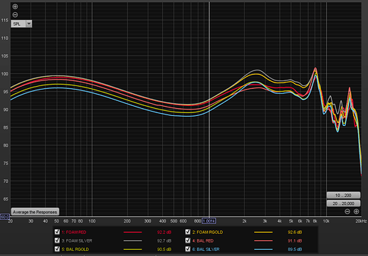

MP145 (All Filters | Foam vs "Balanced’ Silicone Tips)
First attempt at measuring something, so not 100% sure on everything, but is it safe to assume that sibilance I’m hearing in the fricatives is that 8K spike (or if there’s some exaggeration if I missed a step in calibration, seating, etc.) ? Is there a way to bring that down besides EQ (other than the foam tips)?
You should normalise the graphs so it is easier to read.
That 8k peak is a coupler thing but sometimes it is “real”. Personally I had no issues with it using the bass nozzle.
(and no there isnt really anything u can do to cut down 8k besides PEQ.)
Ok, much better. Thanks @Rikudou_Goku .
You can set it to normalize at either 500 or 1000 hz which are the usual spots we normalise at.
800hz also works better sometimes.
(“alignment centre”)
