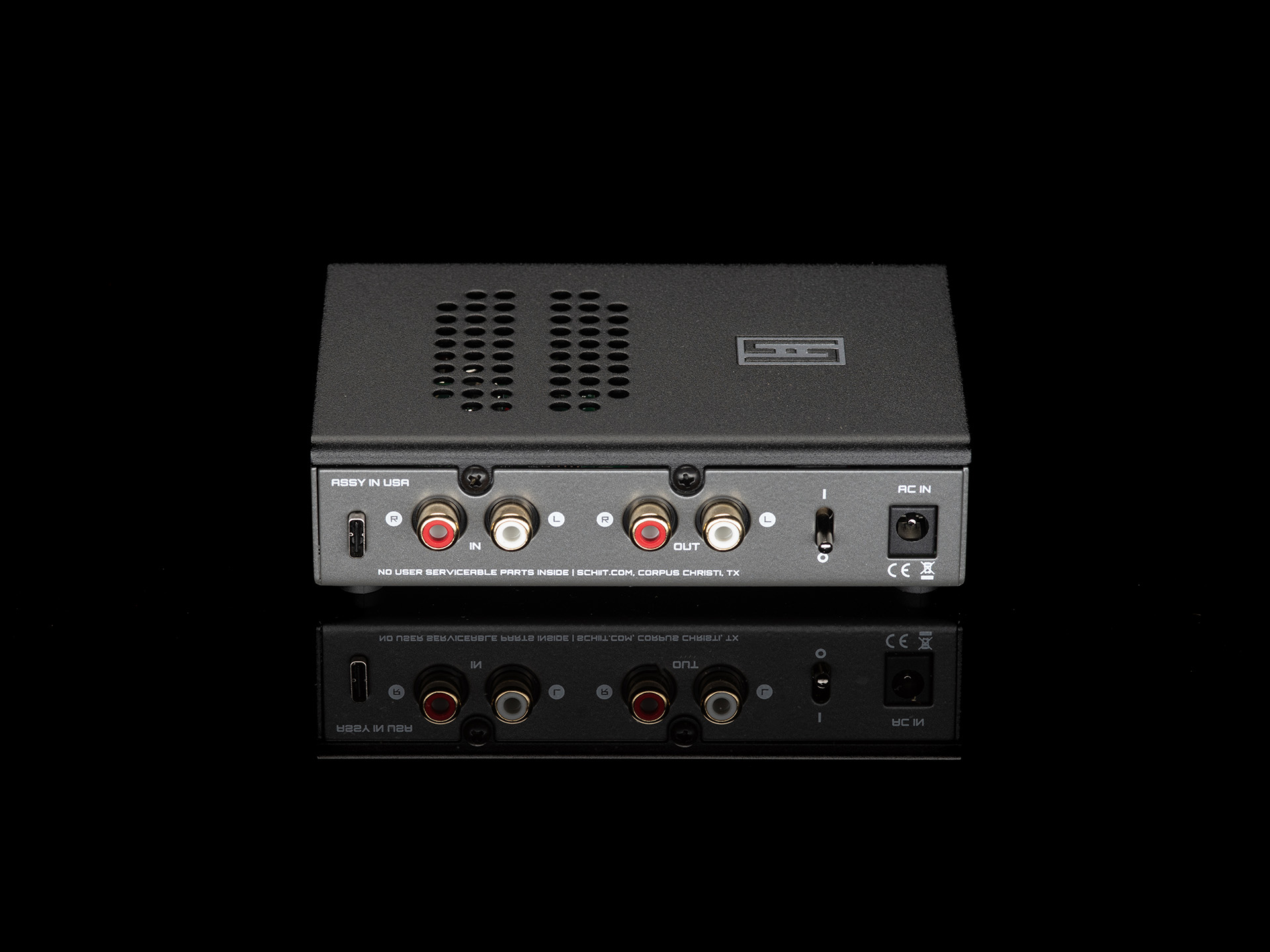

I think I’ll go for best possible route for music, and usb mic is really very nice option. Schiit Magni is great, but I’m afraid it does not have PRE outs, I’m going to also install some speakers and wish to control their volume through all this stuff.
Hi @Lev_Anni , the Magni actually does. Take a look at the back, the pre-outs are present in RCA format. Just for note, the headphone output is muted once the pre-outs are terminated to speakers. I hope this helps! :+1:

Hi @Lev_Anni , if this question was aimed at my last comment (I take it that it was), apologies for any confusion…I meat to phrase it as mentioned on page 3 of the user manual for the Magni Unity (shown highlighted below).
Again, this is the for the unit I was recommending. I hope this helps! :+1:
