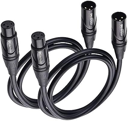

I’m super confused, can you explain how I should connect the AMP and DAC with balanced cables? I’m really confused on this part and I would love to look it up but I’m also at work right now haha :slight_smile:
He means using a pair of 3 pin XLR cables like these between the DAC and Amp.
Oh, on the DAC. I don’t see the XLR cable. Is it just not shown in the picture or am I just blind O_o
Ah, I was looking at the store page, not the info page. Sorry haha
Yep thanks @Polygonhell
