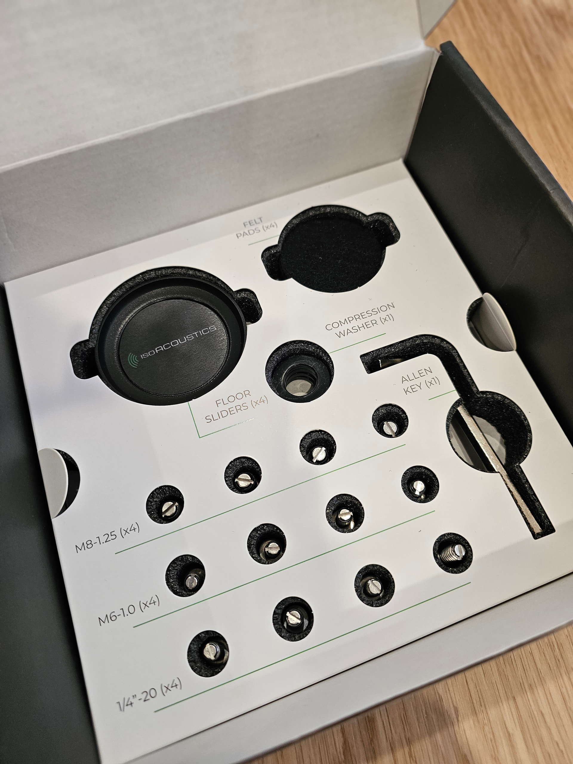

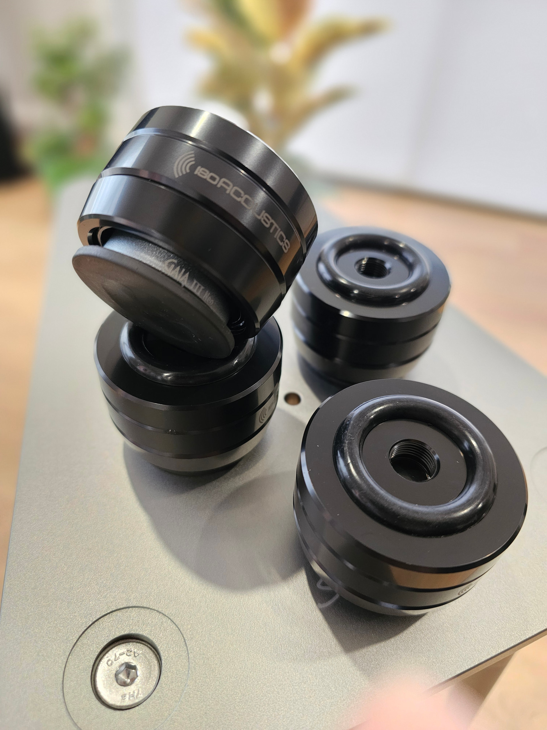

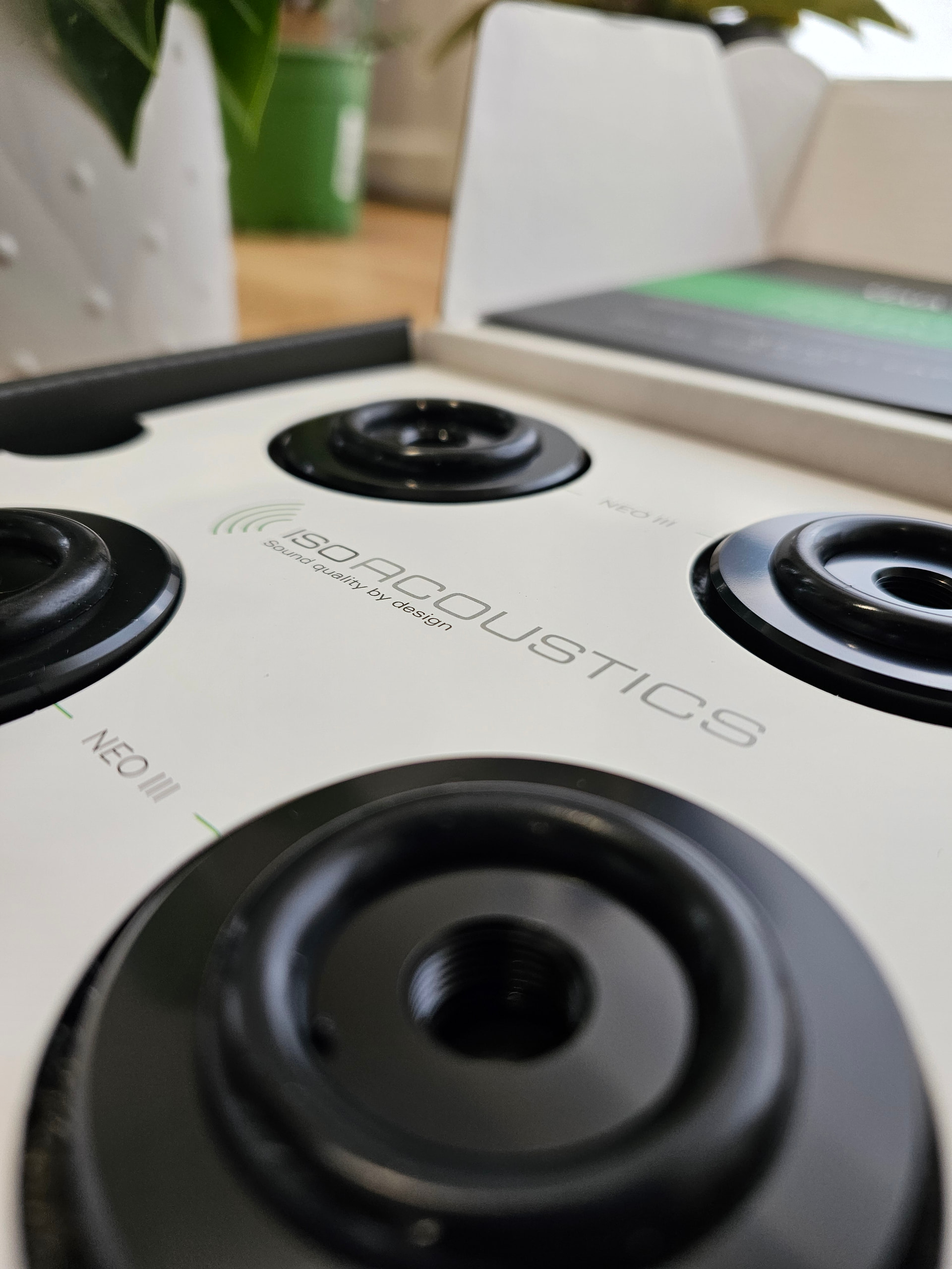

What’s in the Box :

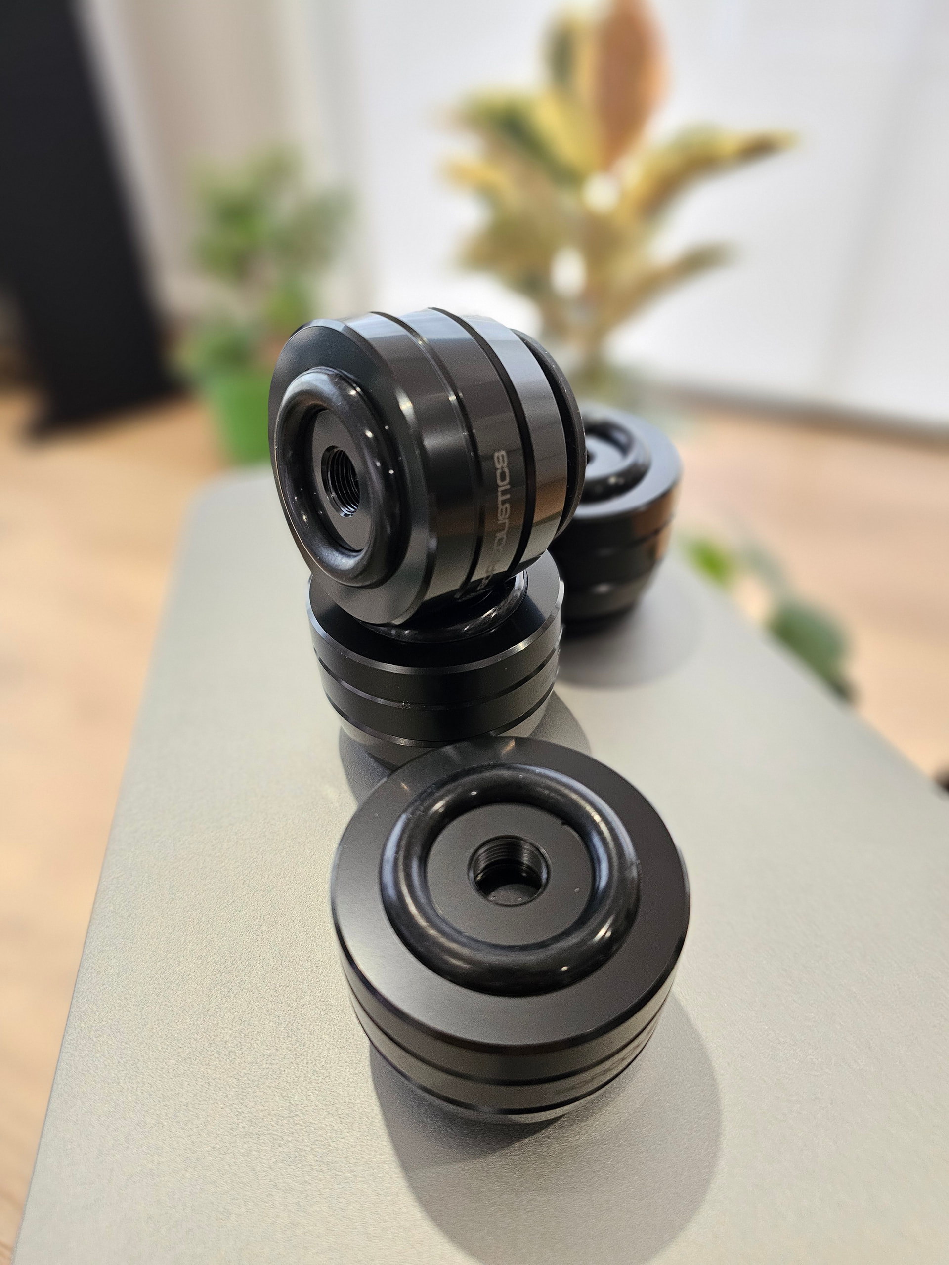

  • 4 x GAIA III Neo Isolators (Machined Metal Housing)
  • 4 x Dual-Surface Floor Sliders
  • 4 x Adhesive Felt Pads (for hardwood protection)
Threaded Stud Adaptation Kit:
  • 4 x M6-1.0 Studs
  • 4 x M8-1.25 Studs
  • 4 x 1/4"-20 Studs
  • 1 x Internal Wrench / Hex Tool

  • Dimensions: 56mm wide x 45mm tall.
  • Weight Capacity: Strict 32 kg (70 lbs) maximum per set of four.
  • Height Adjustment: 8.5mm of tool-free vertical travel.
My KEF Q950s sit right around 24 kg each, so they fall within the sweet spot of the internal springs. The SVS PB-2000 is around 29 kg, which means it squeaks in right under the 32 kg limit. If either went over that ceiling, the internal elastomer suspension would overcompress, bottom out, and turn the feet into expensive, polished solid metal blocks.

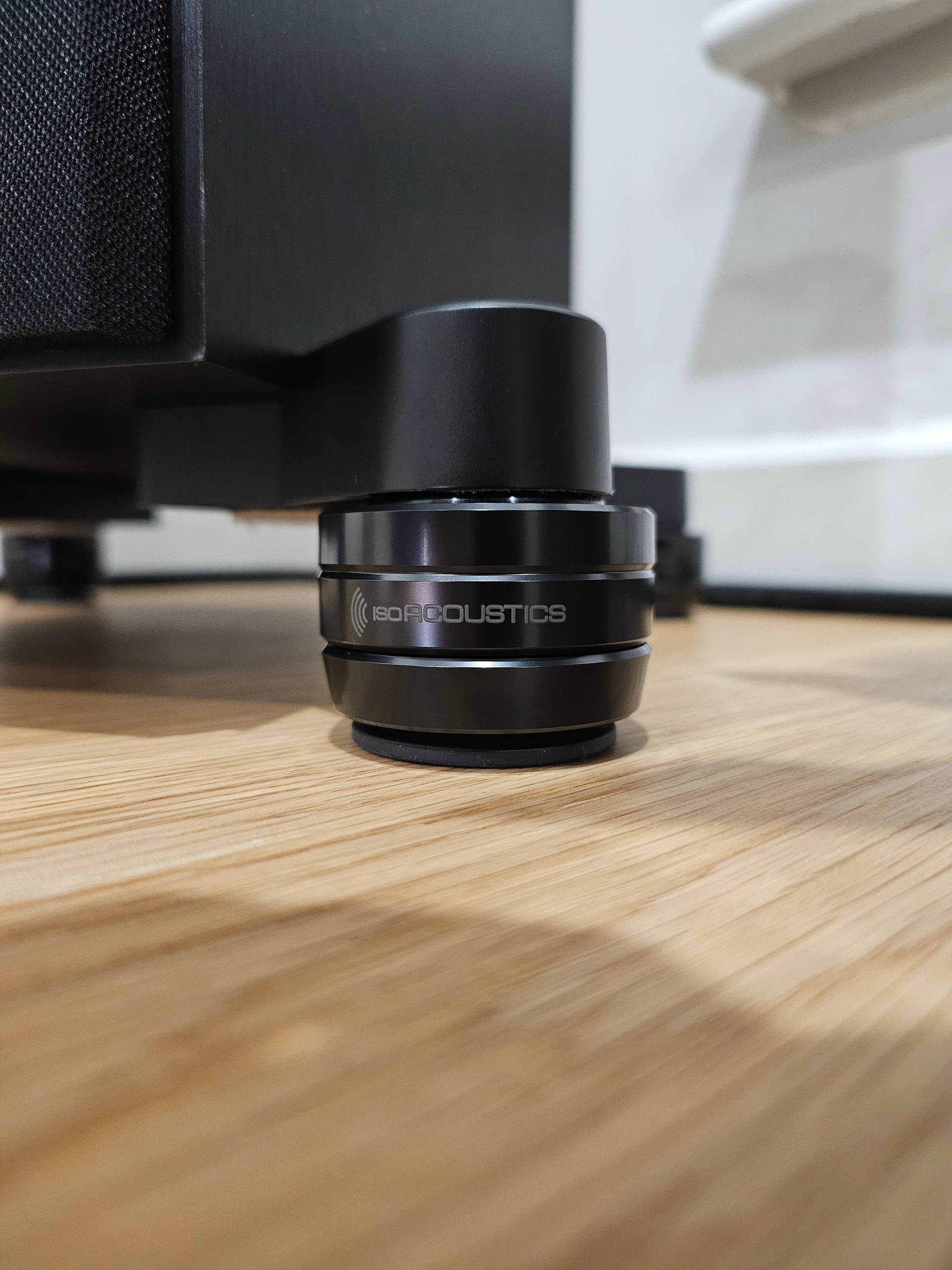

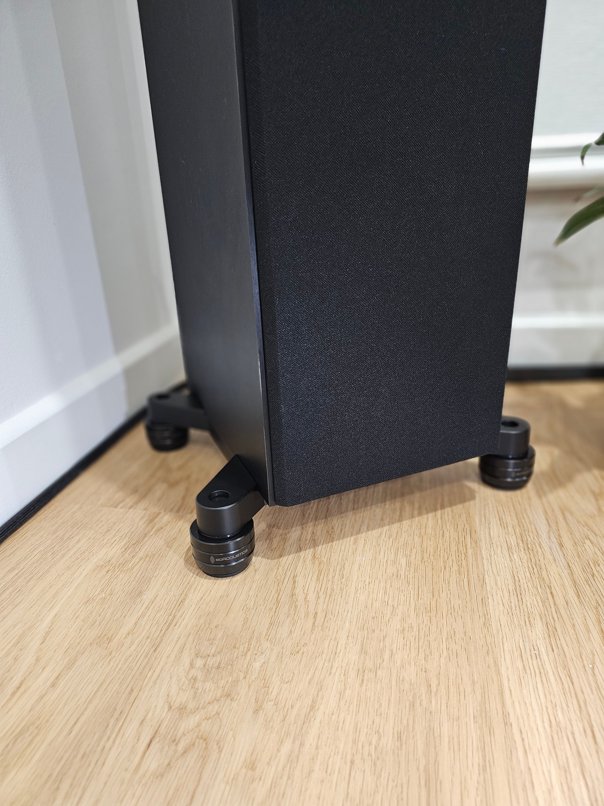

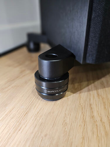

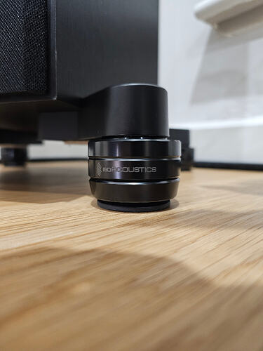

Setup & Aesthetic :
The GAIA III Neo comes in two finishes: a reflective Dark Chrome or Black. I wanted the feet to be discreet and blend into the bases of my speakers, so I opted for the Black.

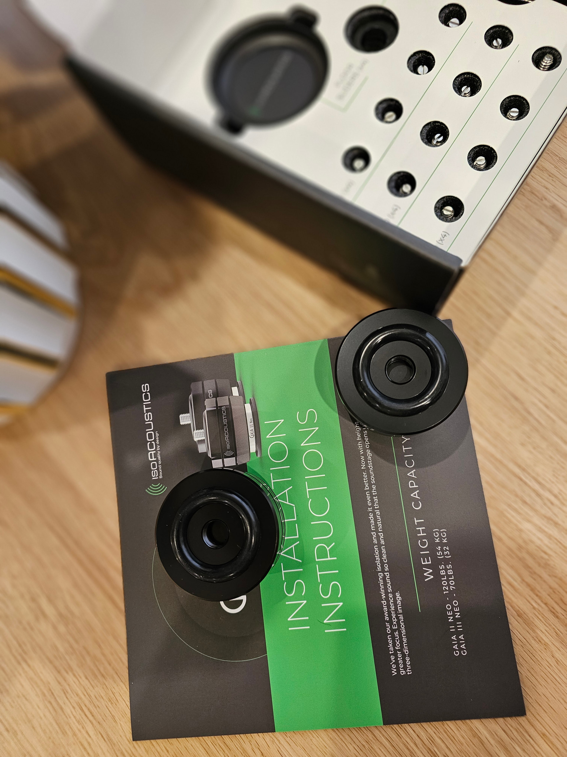

One of the complaints I read about the older, first-gen GAIAs was how difficult they were to install; people disliked wrestling with tiny spanner wrenches and tedious two-part jam nuts that shook loose. Thankfully, since these are the new Neo versions, IsoAcoustics overhauled the design:
  • The Compressed O-Ring: The top of the metal housing features a thick, integrated rubber O-ring. You thread the included M8 stud into the bottom of the speakers and screw the GAIA Neo body on until it sits flush against the cabinet base. The compressed O-ring acts as its own high-friction lock. No tools needed, super simple.
  • On-the-Fly Leveling: My floors aren’t perfectly level, but adjusting height on these is very intuitive. There is an independent silver lower collar ring you can twist to adjust the height up to 8.5mm on-the-fly without needing to spin the entire footer casing.
  • The Floor Sliders: Moving heavy hi-fi gear around usually risks a slipped disc or a ruined floor. Slipping the included Dual-Surface Floor Sliders under the heavy Q950s allowed me to glide them around the room to find the perfect listening spot before tilting the cabinets back to remove the discs.
While these feet raised my speakers off the ground by an extra couple of centimeters compared to the stock spikes, the visual payoff was a surprise. Even in the discreet Black, lifting the massive cabinets up on these heavy, premium pods made my KEF Q950s look less like living room furniture and more like an absolute, high-end hi-fi beast.

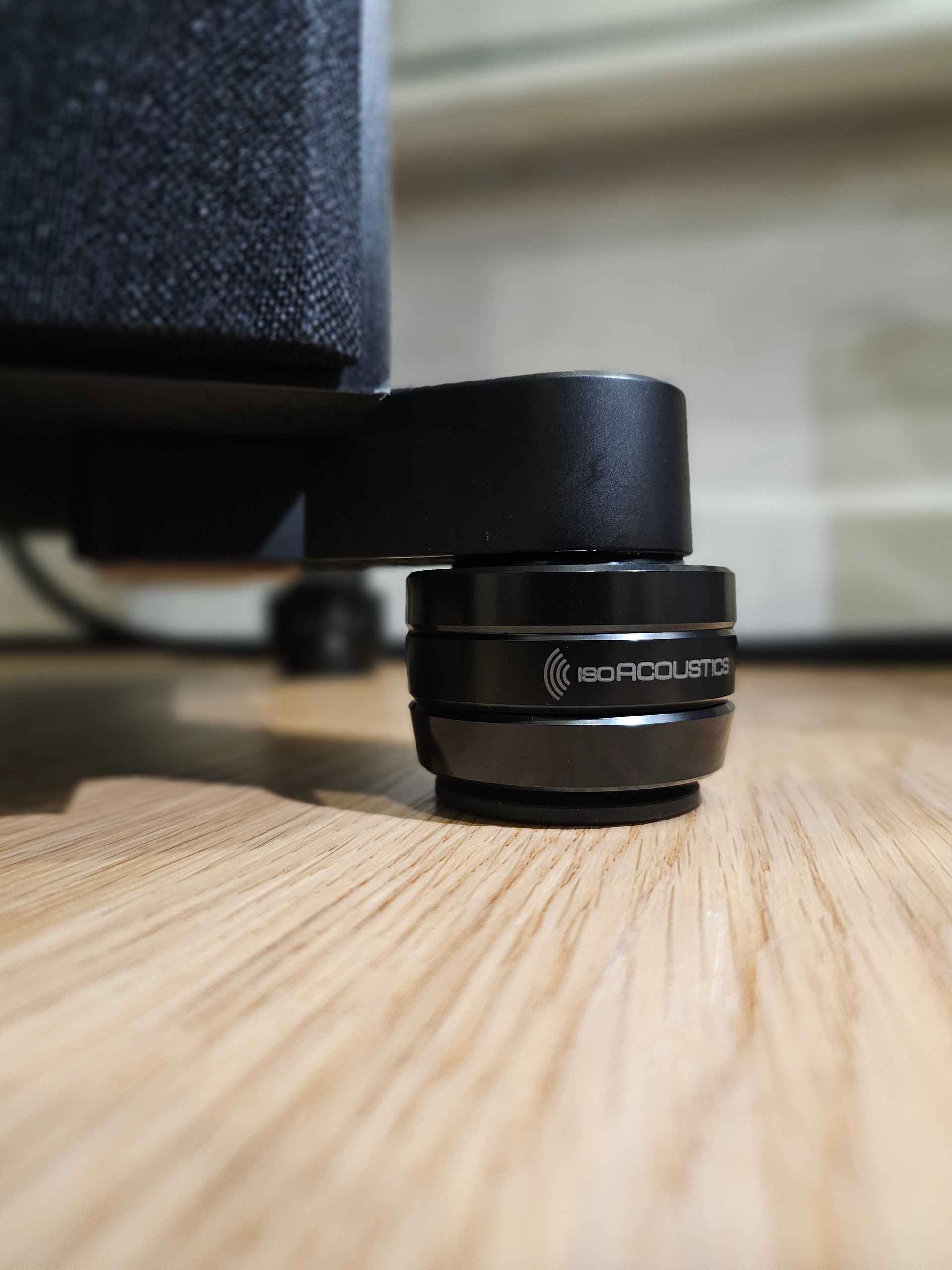

  • The Tweeter Height Shift: Because these stand 45mm tall, they raised my KEF Q950s by roughly 2cm compared to my old stock spikes. Lifting a speaker changes how the tweeter hits your ears. If you feel like your top end softens up after installing them, use that 8.5mm adjustment ring to give the speaker cabinets a very slight forward tilt, aiming the Uni-Q drivers back down to ear level.
  • Carpet Performance: On hard floors, the suction-style rubber bottom grips beautifully. But if you have medium-to-thick carpet with underlay, they can feel a bit floaty or unstable if someone bumps the speaker. If you aren’t on hard flooring, you’ll definitely want to budget for their optional stainless steel carpet discs to give the feet a solid platform to bite into, rather than feeling like your speakers are standing on a trampoline.
