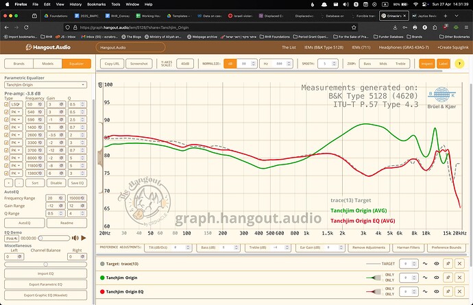

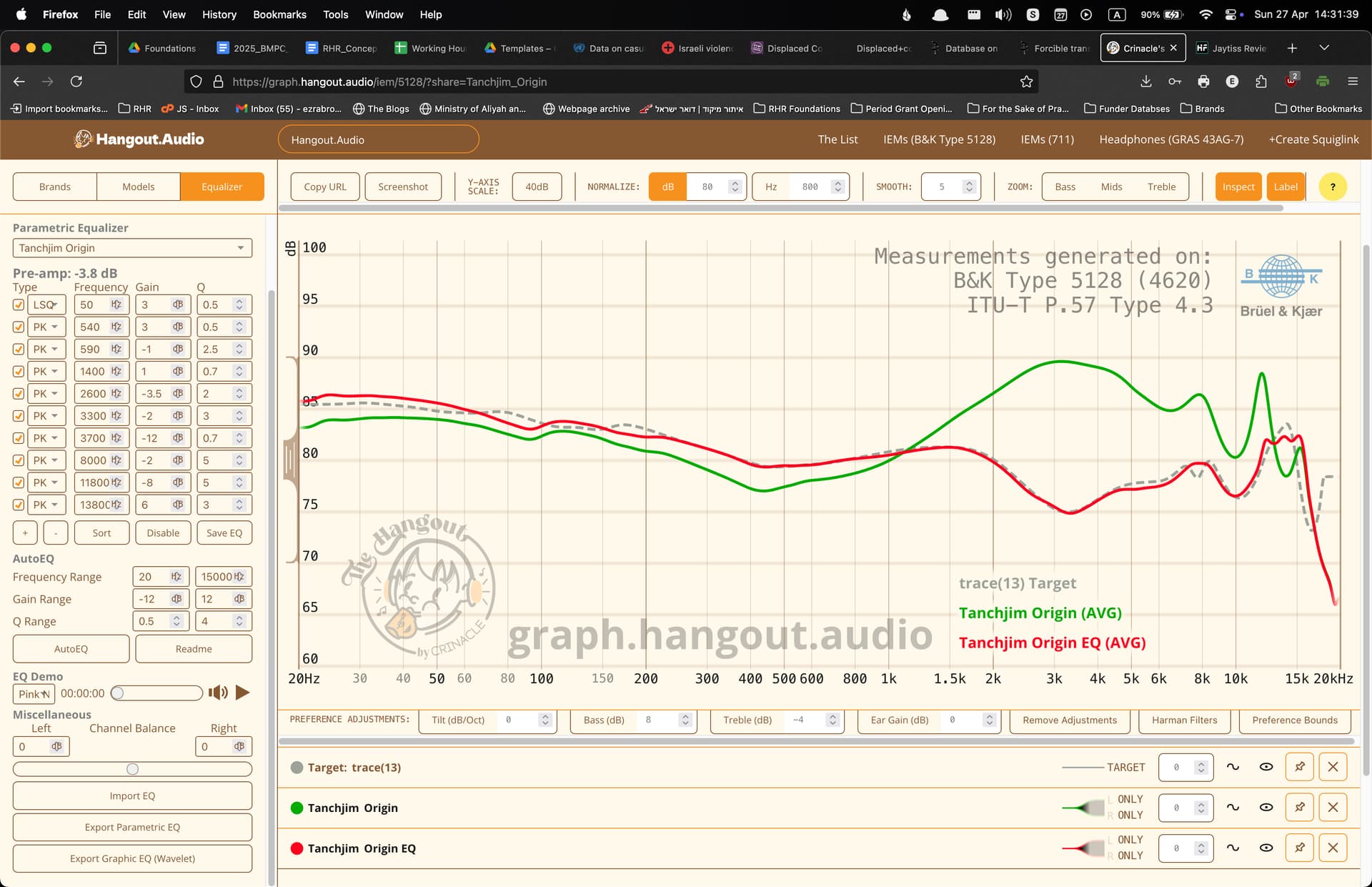

I’ll be messing with EQ right now, I just slapped an EQ setting on the Tanchjim Origin to make it sound like the Supernova but haven’t done any listening tests yet.
I’m aware the Supernova uses some proprietary tech which tames the lower treble, as seen on antdroid’s Supernova FR.
I would highly encourage you to use a 5128 graph set for matching EQs in the treble, as they better represent that area than IEC couplers. I think crin/the Hangout have both of those models graphed. You can download the graph of Supernova, re-upload it as a target curve in the EQ section on Squiglink, and then match the second set to that one. Then use a sine wave sweep (I use Szynalski) to see how it works in your ears and adjust to taste.
Actually, I see that you can’t download graphs on the hangout site so the process is more complex. I had some time so I did this for you and matched the EQs. Here are the values:
Preamp: -3.8 dB
Filter 1: ON LSC Fc 50 Hz Gain 3.0 dB Q 0.500
Filter 2: ON PK Fc 540 Hz Gain 3.0 dB Q 0.500
Filter 3: ON PK Fc 590 Hz Gain -1.0 dB Q 2.500
Filter 4: ON PK Fc 1400 Hz Gain 1.0 dB Q 0.700
Filter 5: ON PK Fc 2600 Hz Gain -3.5 dB Q 2.000
Filter 6: ON PK Fc 3300 Hz Gain -2.0 dB Q 3.000
Filter 7: ON PK Fc 3700 Hz Gain -12.0 dB Q 0.700
Filter 8: ON PK Fc 8000 Hz Gain -2.0 dB Q 5.000
Filter 9: ON PK Fc 11800 Hz Gain -8.0 dB Q 5.000
Filter 10: ON PK Fc 13800 Hz Gain 6.0 dB Q 3.000
And here is what it looks like:
I tried to keep it to 10 bands of EQ; obviously the more you use the closer you can get to an exact match.
