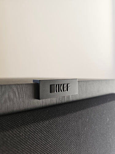

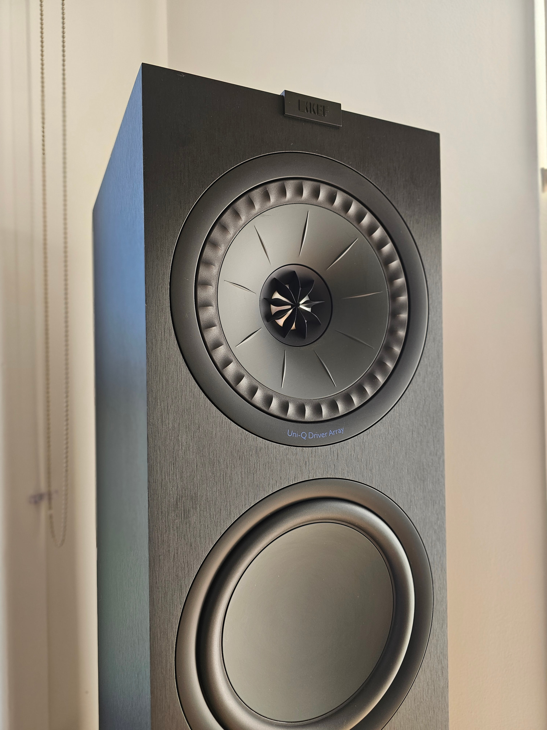

Budget is a big consideration for this hobby; I spent a long time researching and comparing options back and forth before finally pulling the trigger on these. I recently purchased a pair of Q950s from a forum member, which finally gave me the chance to see how these towers handle a real-world setup. These are quite heavy at over 20kg each and they feel solid. However, the external finish is an obvious area where KEF saved on costs. The matte vinyl wrap is functional, but it definitely lacks the premium, furniture-grade feel of the wood veneers found on more expensive lines or even some of KEF’s competitors. It can show wear, scuffs, or oily fingerprints easily if you aren’t careful during setup. Luckily, the pair I picked up were in almost perfect condition, but it’s something to keep in mind if you’re buying new or used.

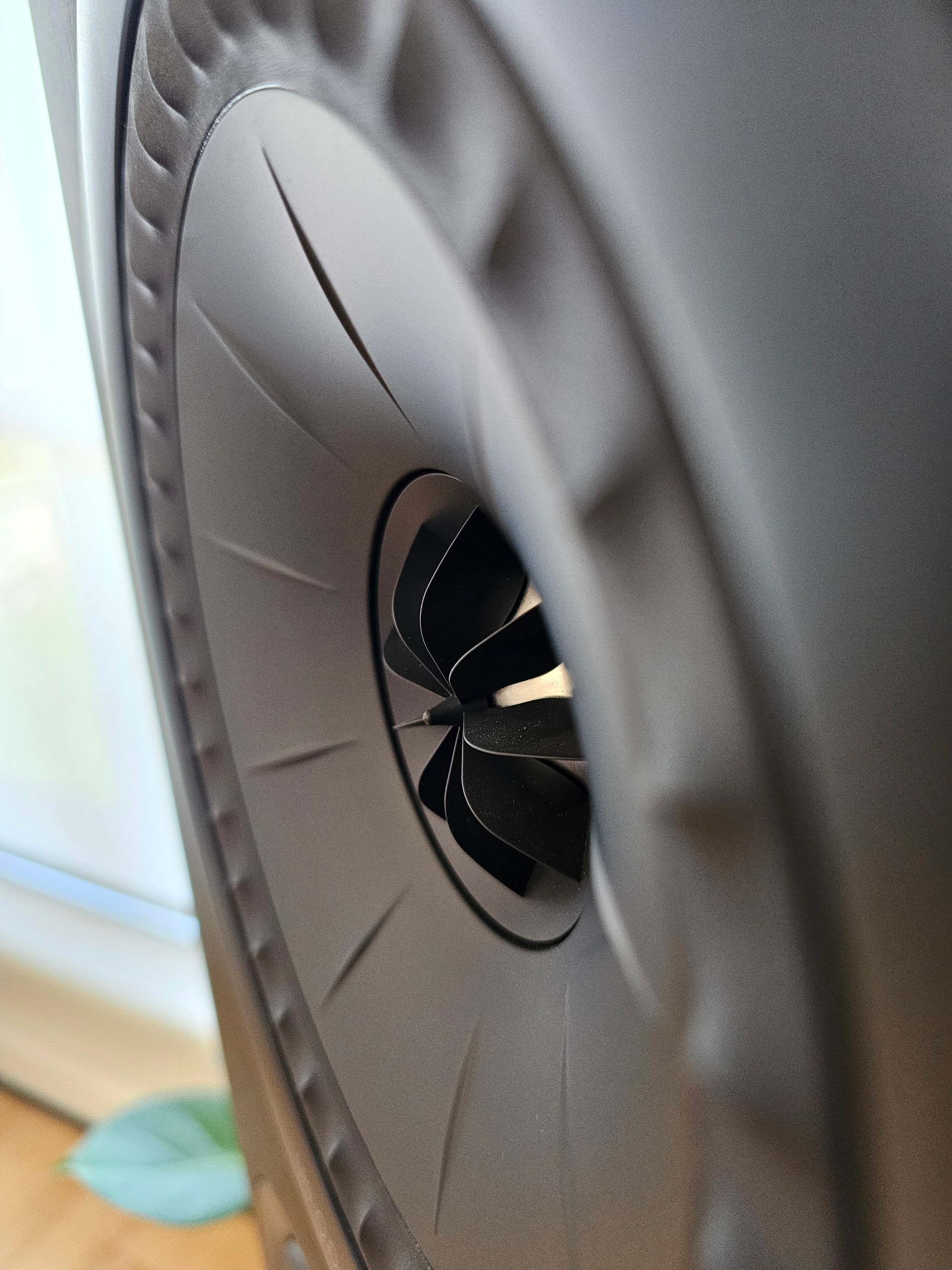

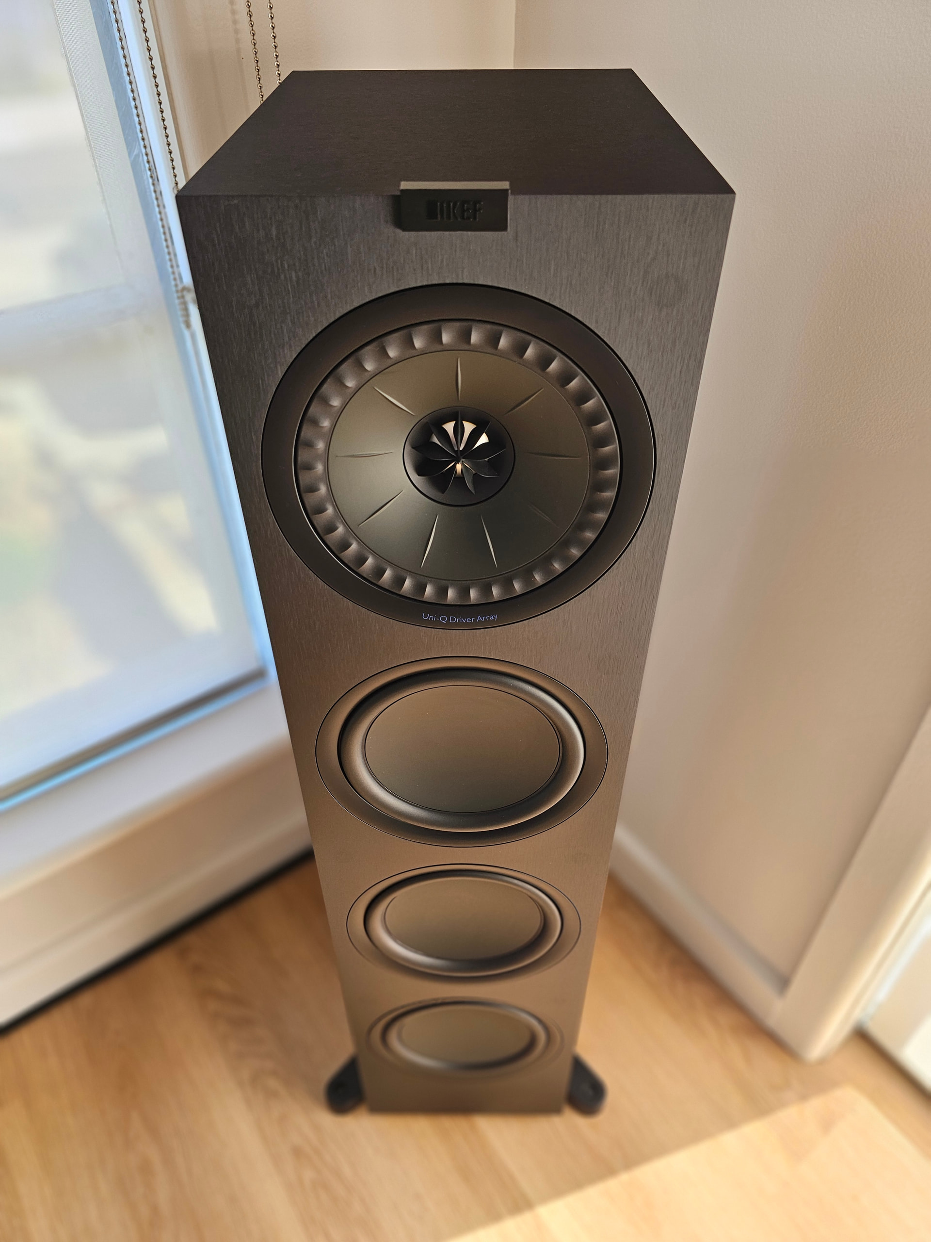

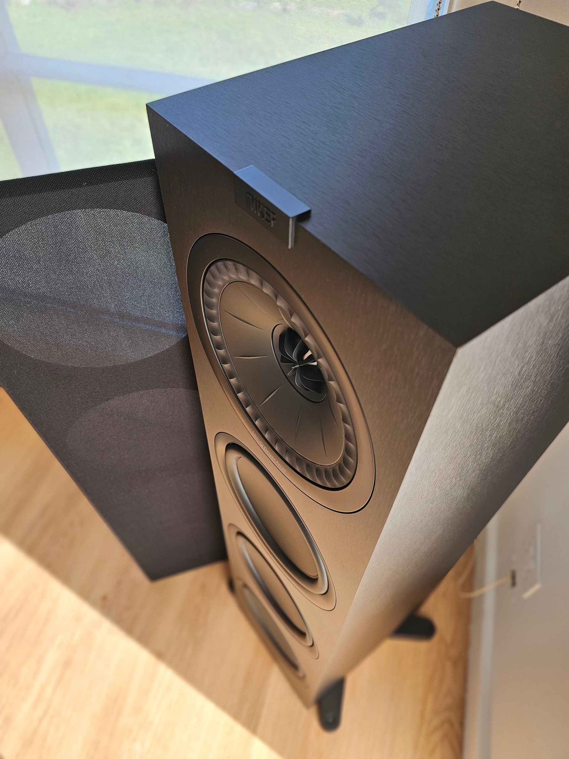

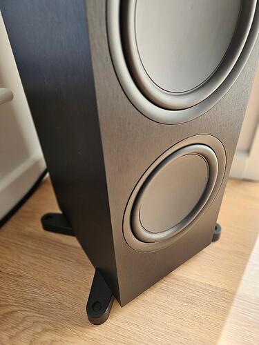

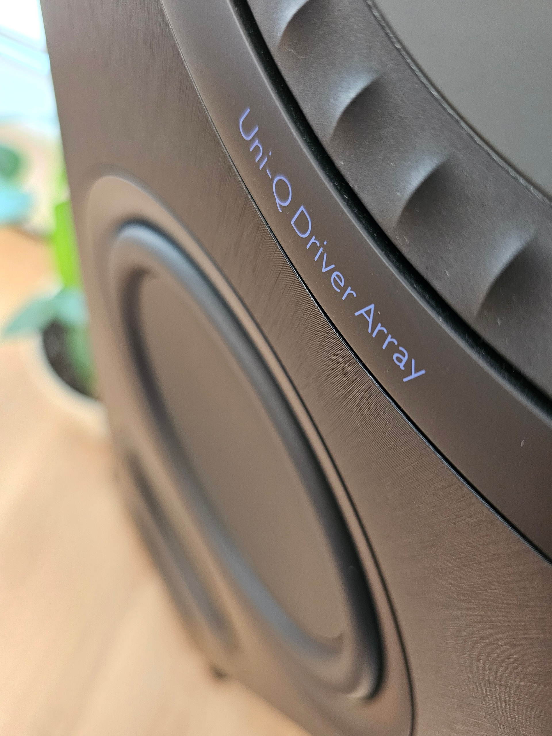

The internal is where these speakers shine. KEF went with a 2.5-way design using that signature 8-inch Uni-Q array. Instead of a rear port, which can make placement a nightmare near walls, they used an active woofer paired with two passive radiators. This made placement easy; I could put them closer to the wall than a traditional ported speaker without ruining the sound with bloated, muddy bass. The flat top of the cabinet also makes a stable base if you use upward-firing height speakers for Atmos.
From my experience, toe-in is not required. Because the Uni-Q driver has such wide dispersion, pointing them straight ahead gives you the most natural treble and a much wider stage. When I aimed them directly at my seat, the highs got a bit too “shouty” and the soundstage felt like it shrunk.
