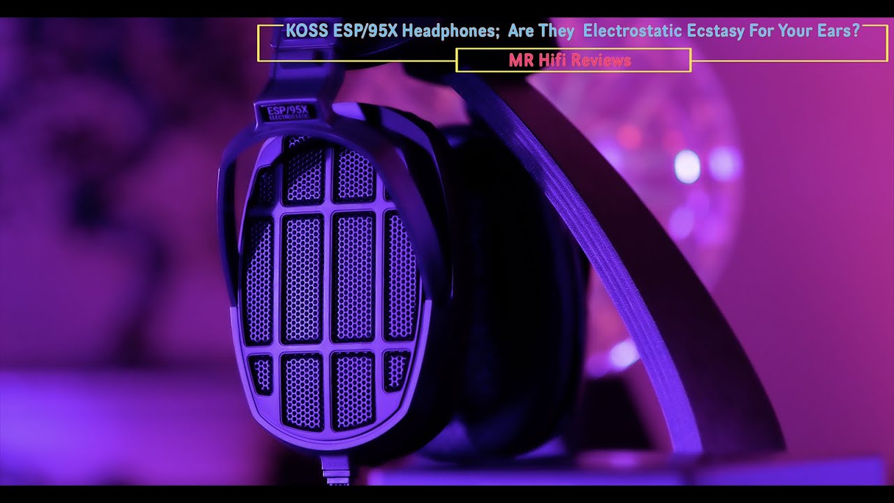

Yes, most likely. I didnât experience that when I reviewed Sheldonâs pair. I would contact KOSS/DROP and see what they can do. Thatâs why I wanted to touch on that during the review that they are a bit more demanding as far as care than typical headphones. Sorry to hear you are having an issue @Coma

Good that you mentioned it in your review!- btw, keep it up, you make quality content
