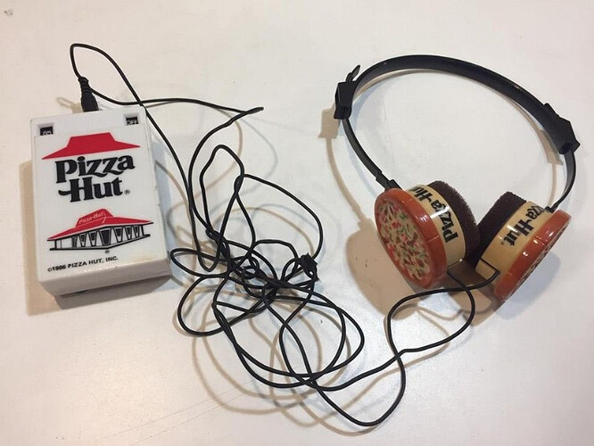

You are all wrong, everyone knows the Pizza Hut headphones from 1986 are the best! :slightly_smiling_face:
What’s the burn in time?..Thin Bass or Stuffed pads?
These are really delicious when you add Topping to them.
Well, you gotta be careful with the higher output impedance of topping, the flavors might clash
