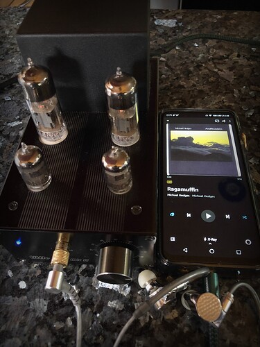

I occasionally use mine to drive my Z1R’s :open_mouth:
