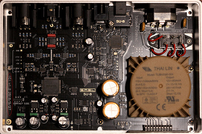

so whats in the bigger desktop DACs that takes up all that space? this is the SU8:
The SU-8 is 5 x 7 inches of concentrated goodness. look at all those components. Now look at this:
how can it compete?
The SU8 is a balanced DAC so it has 2 of pretty much everything.
It also has an LCD display.
Just looking at the board the entire right side is basically power, as is the bottom of the board.
All the big capacitors are there to condition power.
There is an Altera FPGA in the middle, those aren’t cheap parts, I assume it’s being used as a DSP and probably the main uController.
The chips in the upper right probably drive the LCD, but they might also be a USB chip.
The actual DAC bits are in the middle under the 1/4 inch connector above the Altera FPGA.
It’s using a lot more passive components on the actual DACs and the 2 what I assume are op amps, that’s probably again to reduce noise.
The dragonfly has a PIC uController, which is used for the USB interface, and just pushes the signal through the DAC. It relies on you r computer power supply to produce a clean 5V to the USB connector.
When you look at a lot of expensive Audio gear outside of R&D the money is in the Power delivery and passive component quality.
I have a pair if M135 Valve monoblocks in my stereo, they cost $8500 for the pair new, and the manufacturer stopped making them because they couldn’t make a profit on them. All the cost for those is in the 2 transformers and the massive capacitors, the 8 or so valves aren’t cheap by any means, but they aren’t what make it expensive.
It’s one of the reasons you run into diminishing returns so quickly especially with fundamentally digital components. The USB interface should not matter, assuming it can put bytes on a wire at a consistent rate, it doesn’t contribute to the sound. The DAC does, the op amps do.
To be clear here I’m not trying to claim the dragonfly is in anyway better or worse than the SU8, I’ve heard neither.
Yes, the su8 has built in modes not only for the dac filter, but also to add in some harmonic distortion for some more fun sound modes it has without using eq
thats a lot of info, thanks polygon. Yeah i guess there would be a lot of circuits dedicated to power, power managment, LCD, the various ports, a DSP. The USB DACs would not need those things.
