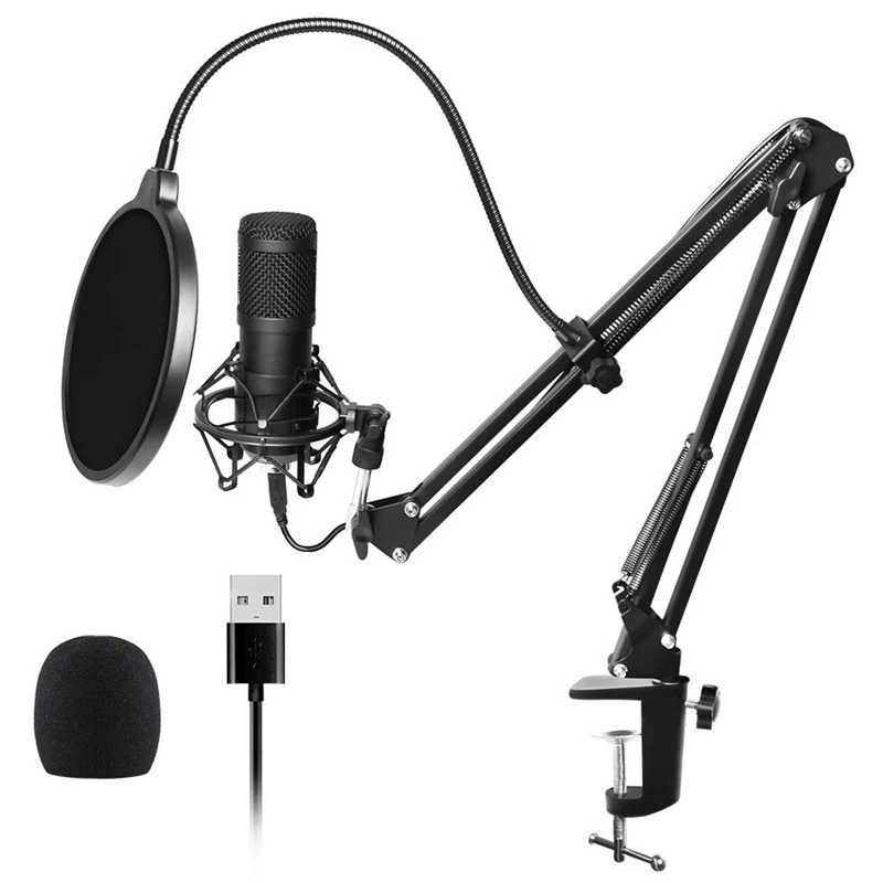

Headset the cooler master mh751/2 isn’t bad but I’d go with a dedicated mic on a boom arm or a samson go mic connect you can prop up on the a monitor and your then free to use any headphone.

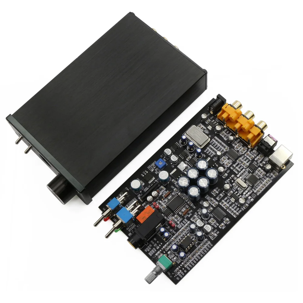

Cheap DAC would be an FX-Audio DAC-X6 which has high gain jumpers and outputs about 1000mw which is great for $65.
Again using a dedicated mic will give you lots of freedom. It’s worth pushing the budget a bit higher in the long run.

If I had 120 for a new setup I’d go DAC-X6 and maybe a shp9500 both of which can be got on Aliexpress. The you just need the mic
A different variant add $20 for FX-Audio both are fine.
Dilvpoetry X6 Pro
FX-AUDIO DAC-X6

Mic
