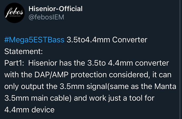

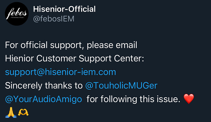

Another statement from HiSenior.
Happier with this one, but still don’t know what they mean in point one…
Yeah im confused by what they are trying to say in point 1…
