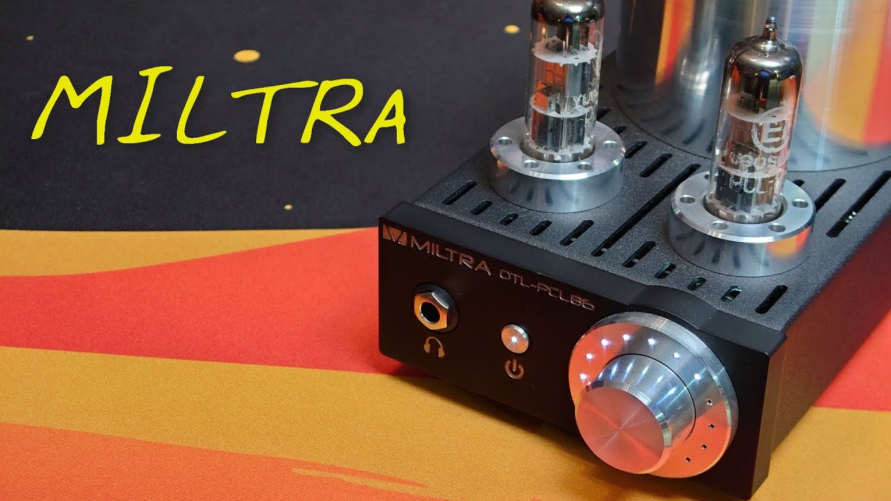

Had an eye on this tube amp for about a month now. Though, there’s hardly any talk about it online. Seems like the total package in terms of performance and build quality. Zeos gave it a glowing review. Looks like a winner to me.
In terms of competition in this price bracket, there’s the Tor amps and Bottlehead Crack + Speedball. Am I missing anything?
I was also looking at the Xduoo TA-26, but the convenience of the Miltra’s volume control is pulling me toward it. Is it worth double the price?

So since the Miltra only has the 2 little tubes, there’s less flexibility in changing the sound when tube rolling? That’s a shame since I do like to tinker with my equipment and I really liked how Zeos described its potentiometer.
I’ll look into the Feliks amp and its tube pairing.
2 is all ya need. he wasn’t referring to the amount of tubes so much as the availability of said tubes. the bottlehead crack uses 2 tubes… more then enough to alter the sound through tube rolling as many have done.
I believe we are all on the same page haha
I was referring to the size of the tubes.
I have Z’s Miltra here now. I picked it up in the Yard Sale, I really like it a lot, I think it definitely punches above it’s weight class. I’m still working towards getting my amps set up so I can shoot it out with the Dark voice and the Elise. I’ve got sooooooo many tubes to roll in these other two but I haven’t really found anything online regarding these pcl86 tubes. And yeah they pretty tiny in comparison to almost any other tube I use, but the sound quality coming out of them is solid.
