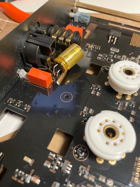

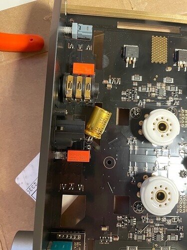

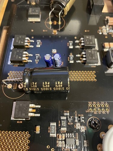

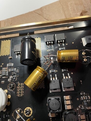

Finished recapping. All caps replaced with Audio Note. Two notes:

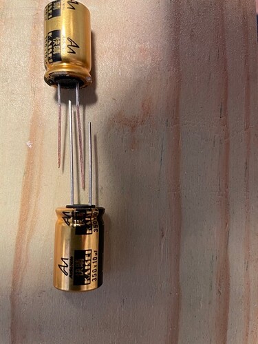

#1 The smaller factory caps have 0.5mm lead diameter and so do the holes. The Audio Note caps have 0.8mm diameter leads. There are two ways to get them in the circuitboard holes. The stupid way: drill out the holes. Doing this risks destroying the solder/contact pads at which point you can throw your amp away. The smarter way: take Dremel and file away some of the diameter off the leads. Pics below.
#2 The Audio Note caps are rated at 85 degrees. Several (I don’t remember which ones) of the factory caps are rated at 105 degrees. I don’t know if any area of the amp actually gets close to 85 let alone 105 degrees but to be safe and prolong the lifespan of the caps I did two things. Got socket savers to lift the tubes out of the chassis. Arranged the caps on the board so they are as far as is feasible away from heat generating devices/areas. It’s why they appear to be at random angles on the board.
