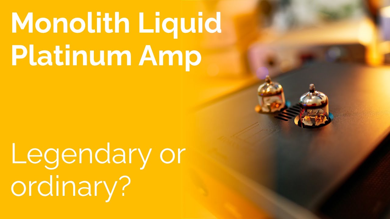

Interesting review. I guess it depends at what price you get one. I bought open box from monoprice which was a lot cheaper than 1000 usd he said in review(shiping and customs to EU included). And also I bought it to pair it with planars bigger than sundara so he could test e.g. arya with it. But will see once I have it

Comparing this to $1000 plus amps is a joke which makes the reviewer’s pov a puzzling one to take.
I was also puzzled by this review. He overpaid which seemed to frame everything after in a nagative light. But he also commented on poor spatial performance, which IME is not an issue with MLP. It is true that MLP can have some trouble with volume pots, though.
Yeah I think as @WaveTheory said he “overpaid” and as @db_Cooper said he was judging the LP’s total cost/value to him as opposed to getting it at basic list and local shipping, then add on any tube rolling etc

I stopped paying attention to this guy when he started talking about the differences he hears in USB cables (surprise - the audio jewelry sounded better). This is also the only review of his that I’ve seen that was negative so that’s pretty weird for a widely acclaimed product. Maybe he has golden ears and I don’t
Although tbh, after doing the cap mod I realize that the stock build is gimped with cheap parts so maybe there’s something to his review. And we all know about the stock pot and gain so there’s that…
