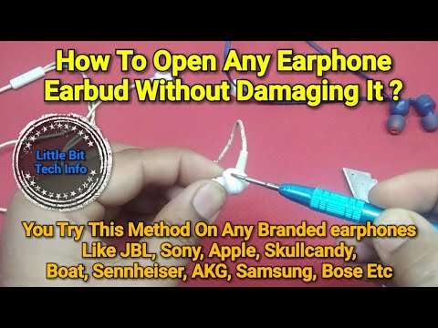

u said that u have opend one iem ,so what is the best way to open it
I used an exacto knife to pry it open, and be sure to take your time and do it slowly where you can see the seems of the IEMs, you know, the little gaps in the center of your IEM? That’s is where you slowly put your knife on it and slice it up and down slowly.
Here’s a video that can serve as a guide.
On my Aria, one side almost fell open when I applied pressure, and the other side took around 20 minutes of working on the glue with an Exacto knife. I took several breaks because my hands were cramping.
Yep, same as me when I did the Katos. Not going to lie, I was tempted just fucking smashing it open with enough force just to get it over with but I am glad I persisted patience and was able to open it.
