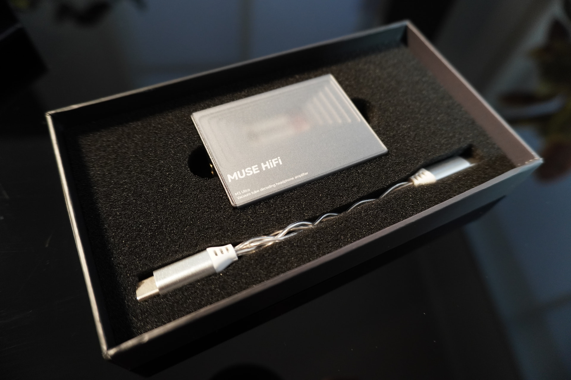

  • The Muse HiFi M3 Ultra hardware unit itself.
  • Braided USB-C to USB-C cable
  • USB-C female to USB-A male adapter
  • User manual

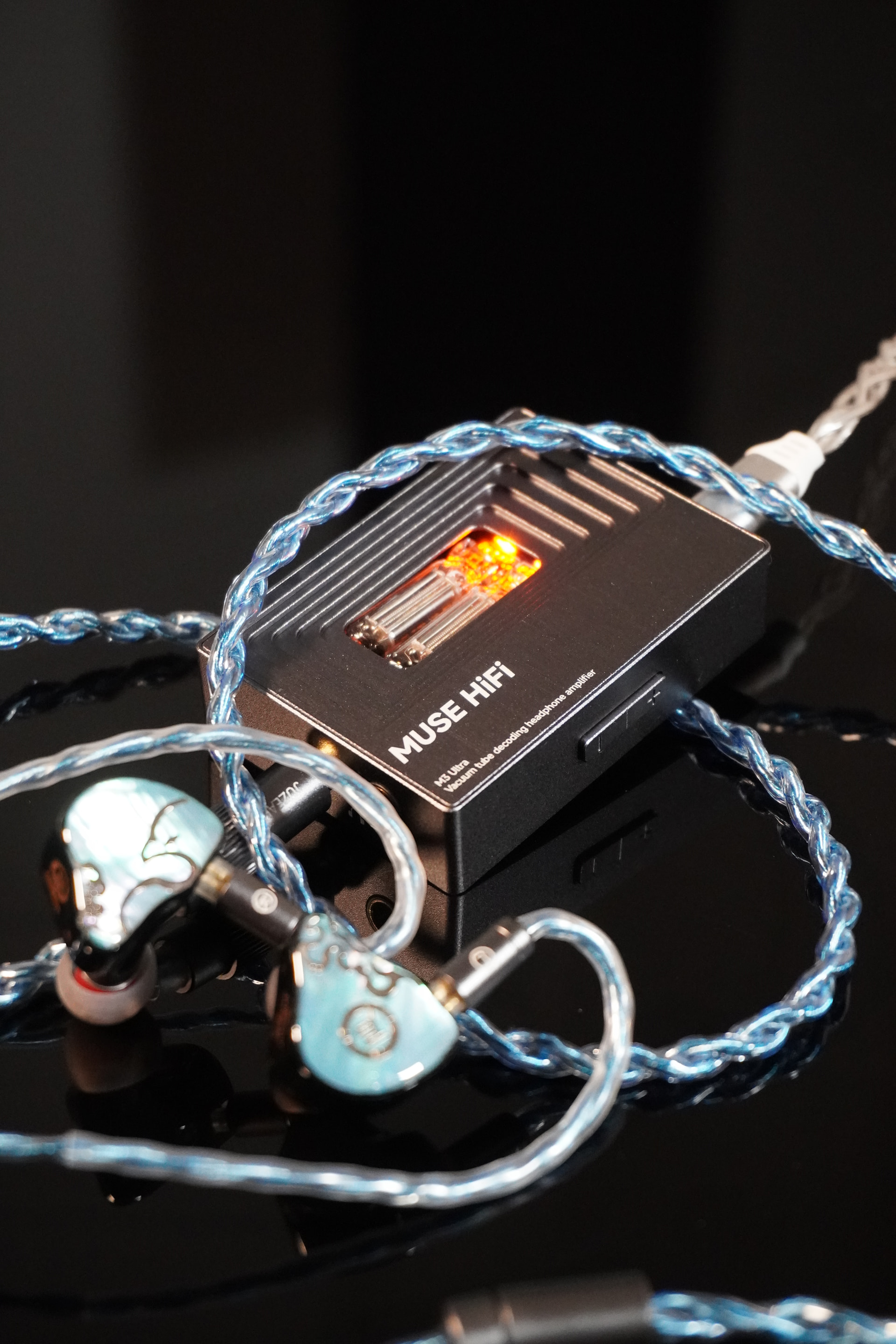

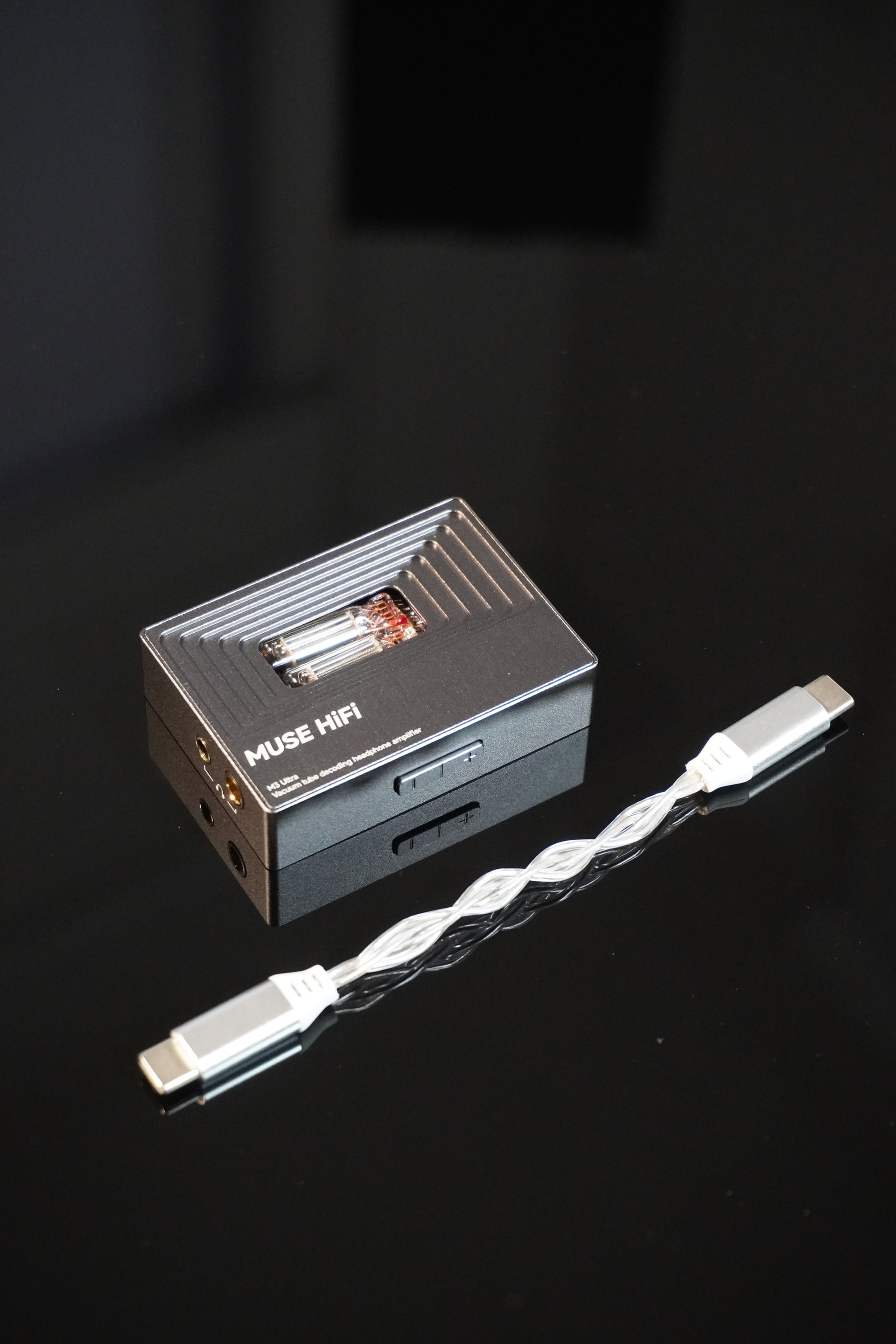

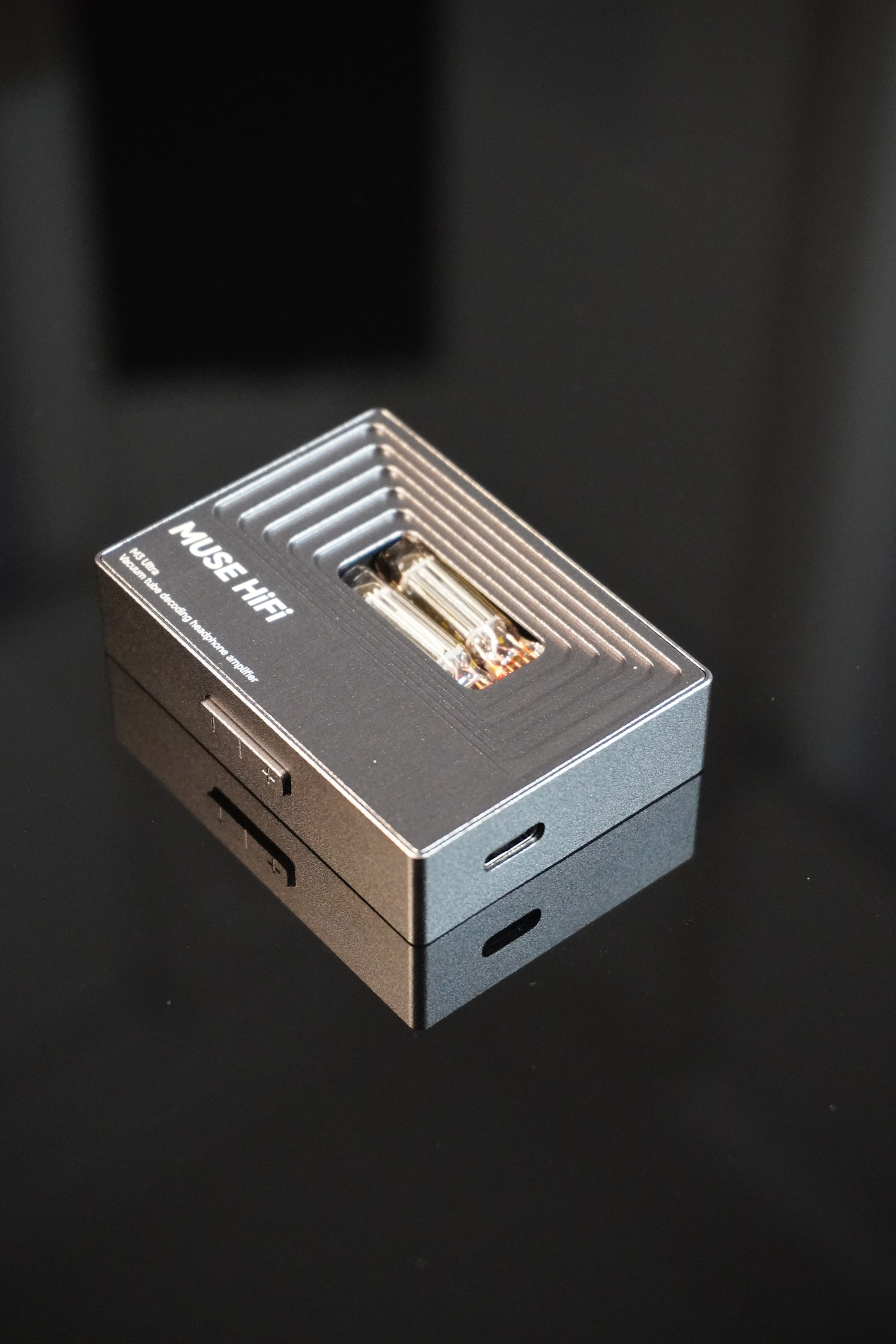

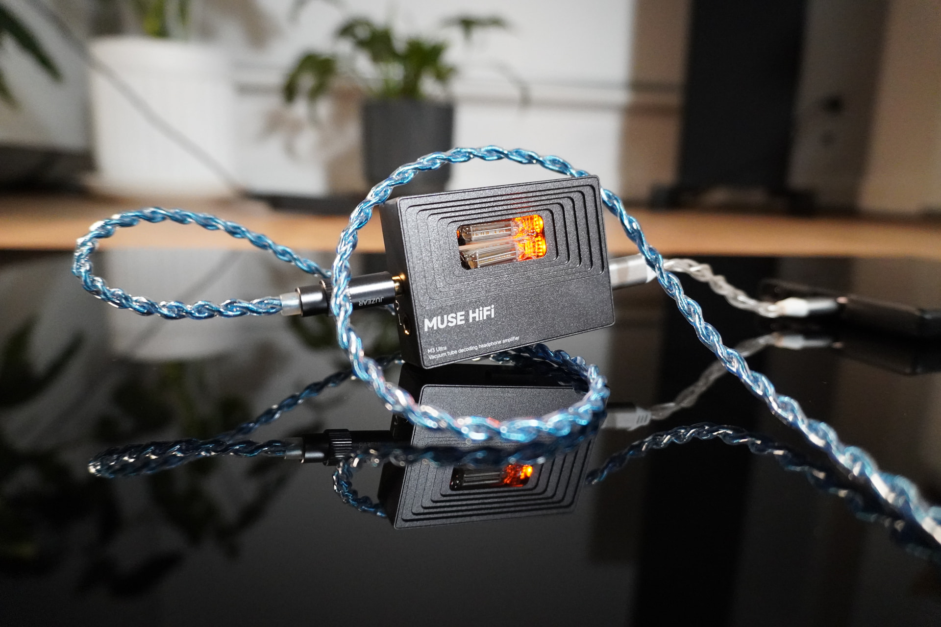

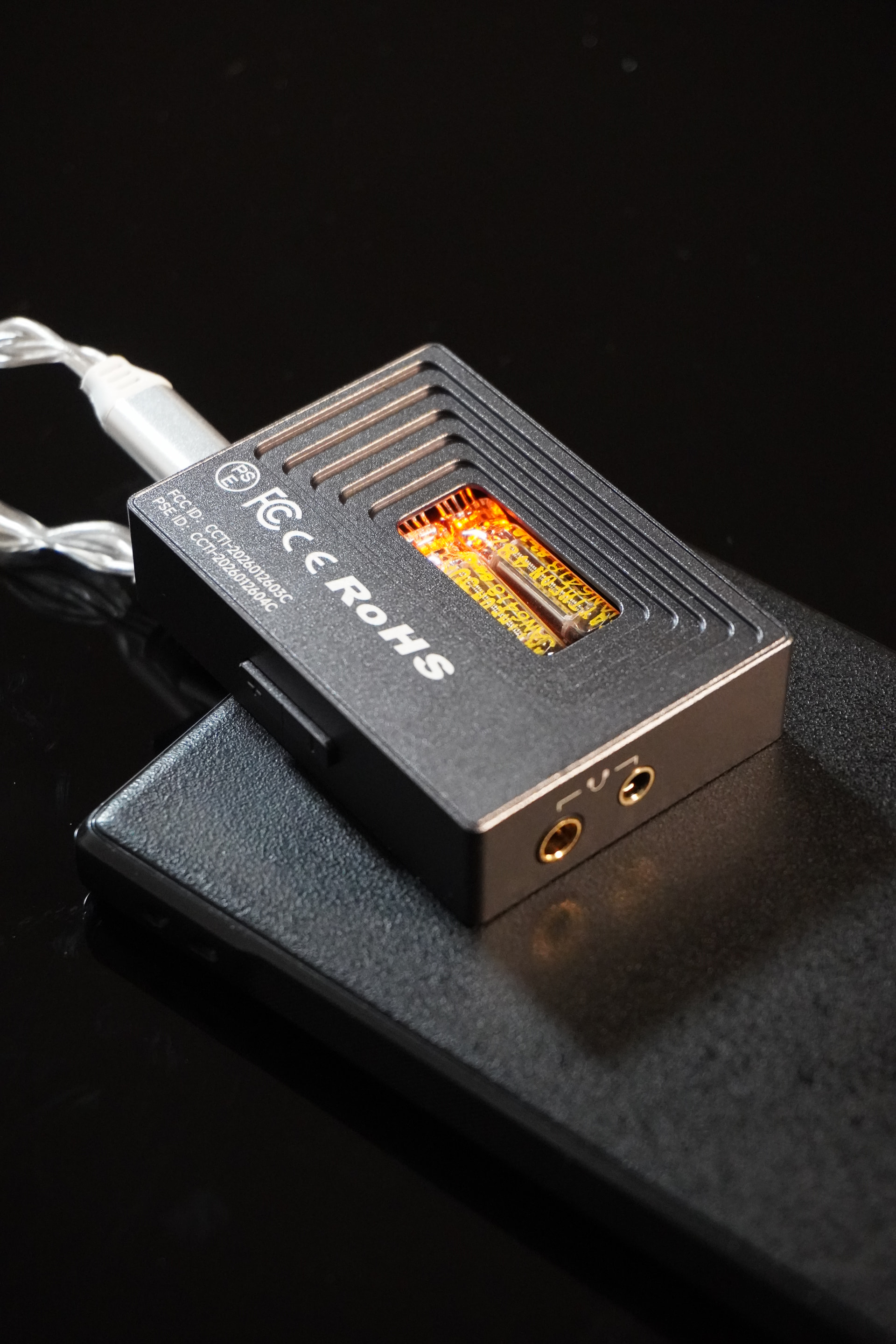

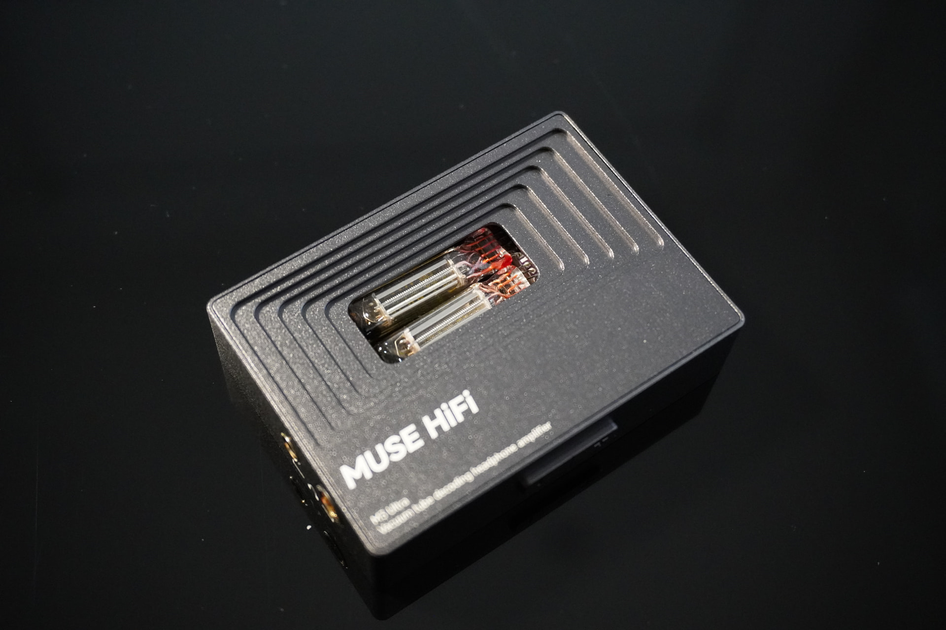

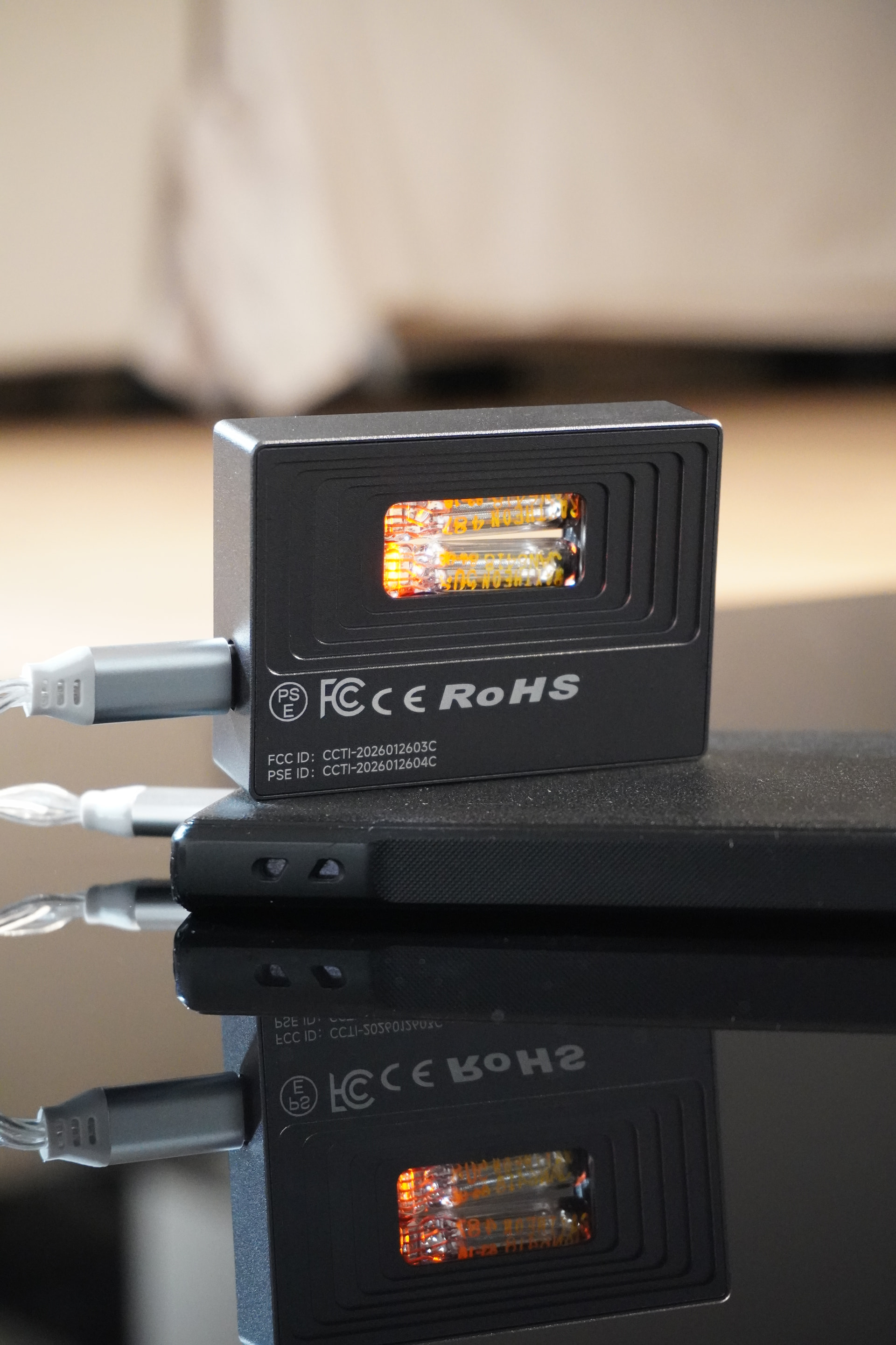

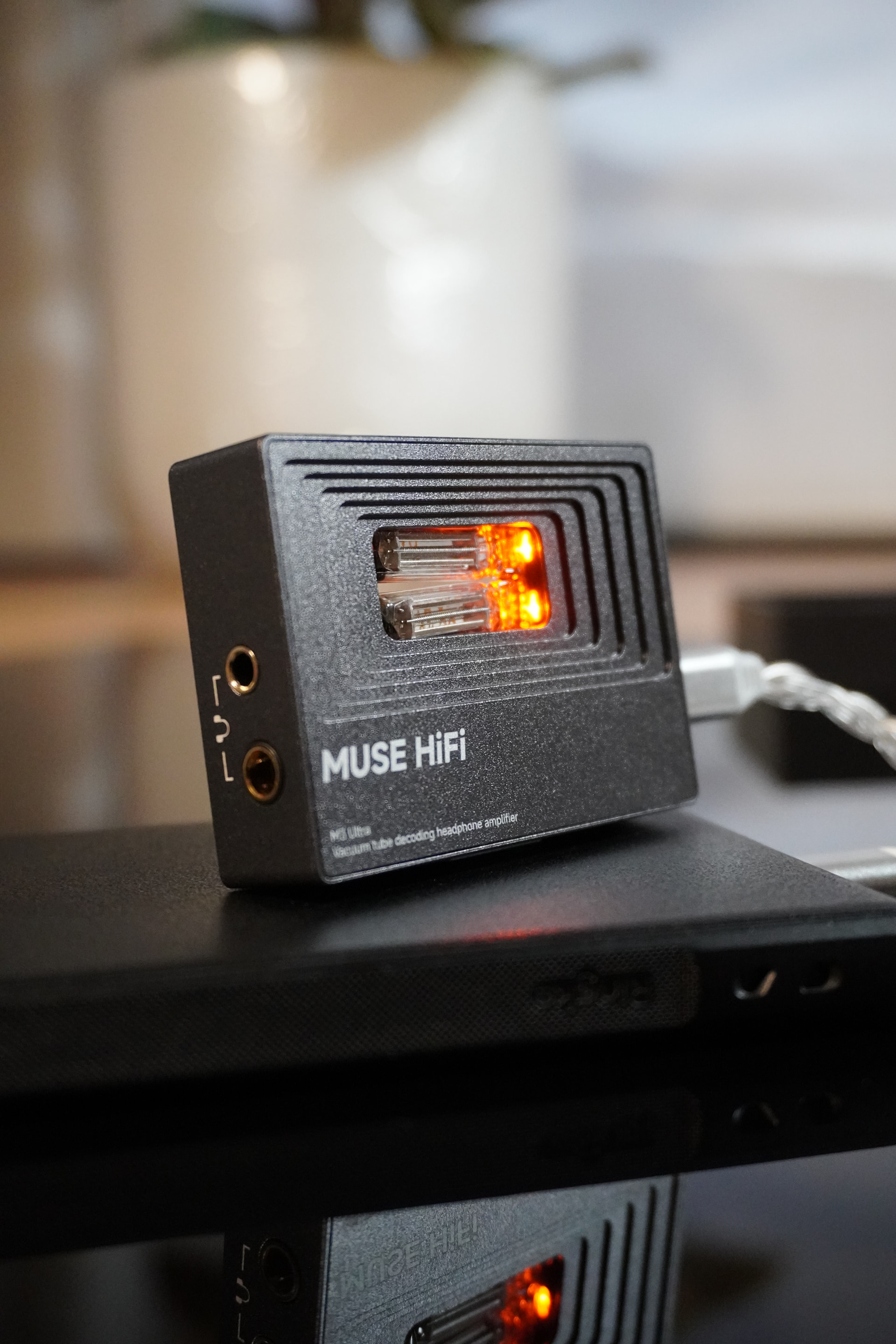

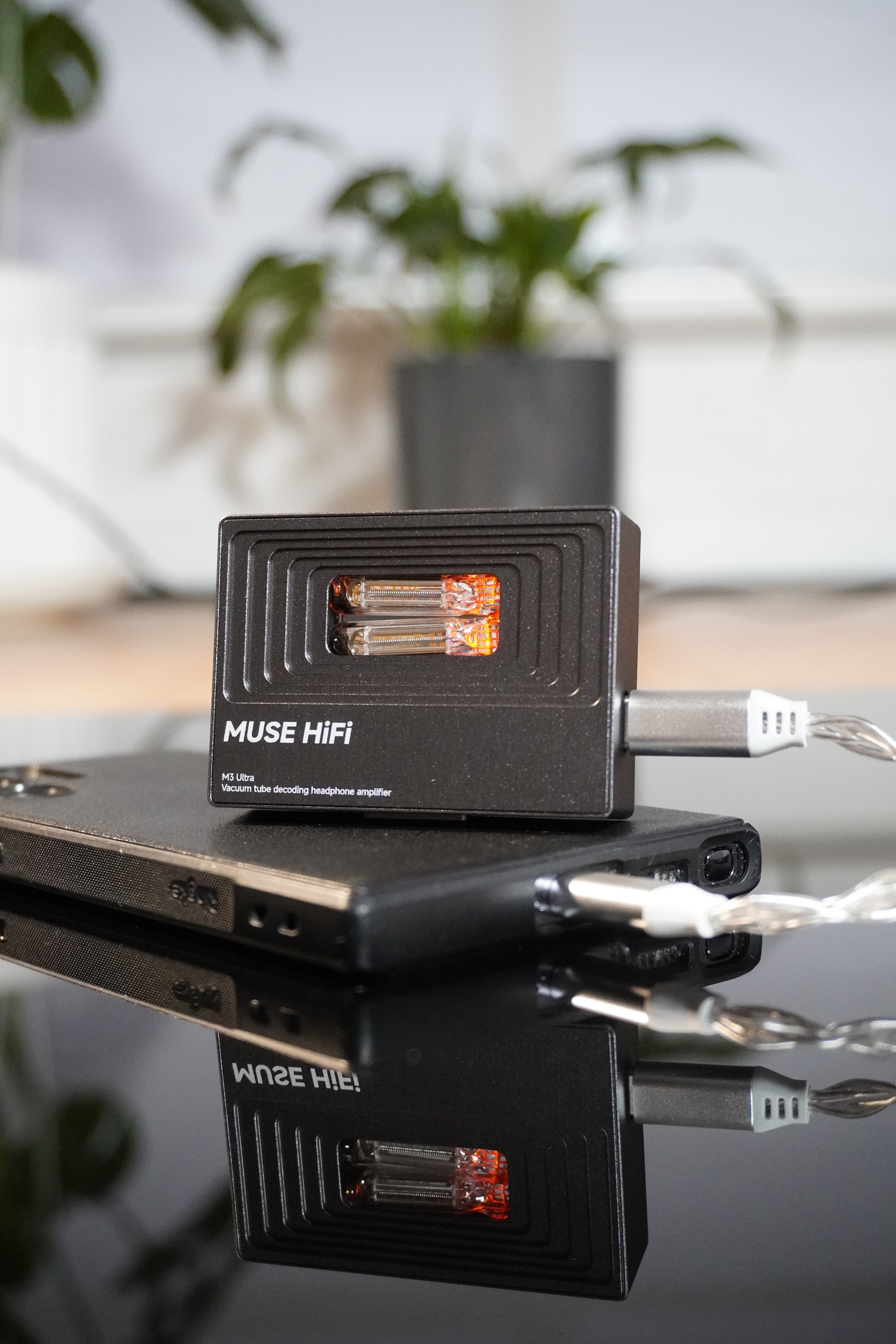

The M3 Ultra weighs 55 grams and sized roughly like a small stack of credit cards, it feels solid due to to its CNC-machined aluminum chassis. The product is essentially a hollow, open cutout on the frame that lets you see the bare dual vacuum tubes glowing orange when powered.
While it is cool, something to keep in mind is that there is no glass covering the window, the vacuum tubes are exposed. It collects dust and I would be careful to toss into a pocket with keys or lint. Handle it with a bit of care.
Design is of a minimalist approach; no screens, no Bluetooth and no companion software bloat. It features physical, machined metal volume up/down buttons. The built-in volume memory is practical, as it automatically remembers your volume tier even unplugged. Heat dissipation is excellent; after a three-hour session, the metal shell barely feels warm.

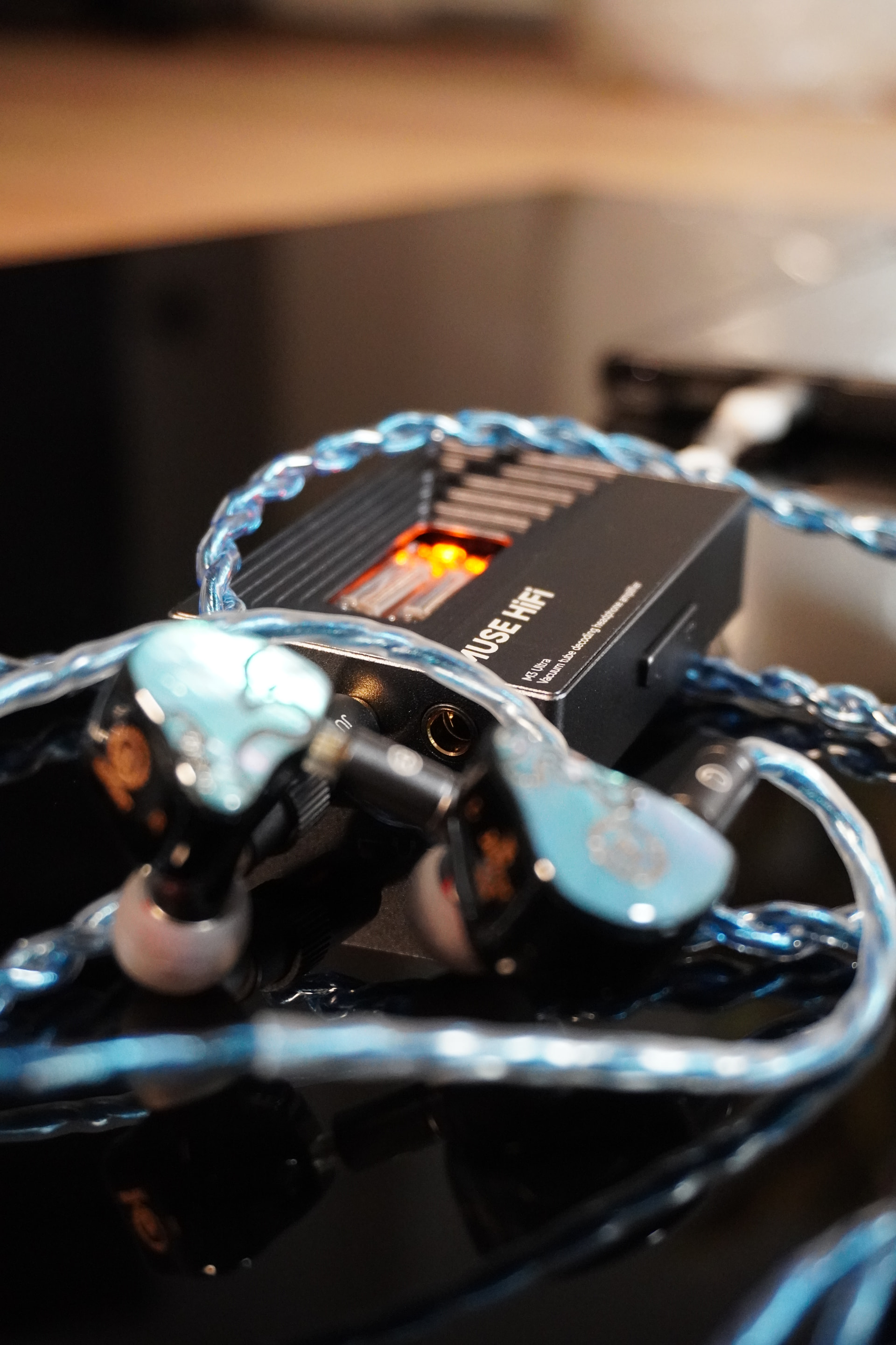

With the 4.4mm balanced plug, I had great amounts of dynamic headroom with the Audio Technica ATH-R50x, rarely needing to cross the 50-60% volume threshold to get a punchy, fully awake presentation. The efficient Juzear Defiant hybrid IEMs were driven effortlessly with power to spare.
Keep in mind that these numbers won’t replace a proper wall-powered desktop amplifier for demanding gear. If you hook up heavy, hard-to-drive planar magnetic headphones, the sound will lose its tight bass control and start feeling flat when you turn the volume up loud.
Portable tube amps are usually affected by two major issues: phone radio static and microphonics; that annoying metallic ringing sound you hear in your headphones every time the device bumps against a table. Muse HiFi fixed this by mounting the tubes on physical silicone shock absorbers and adding an internal noise filter. It works amazingly. The background is dead silent even with highly sensitive IEMs.
