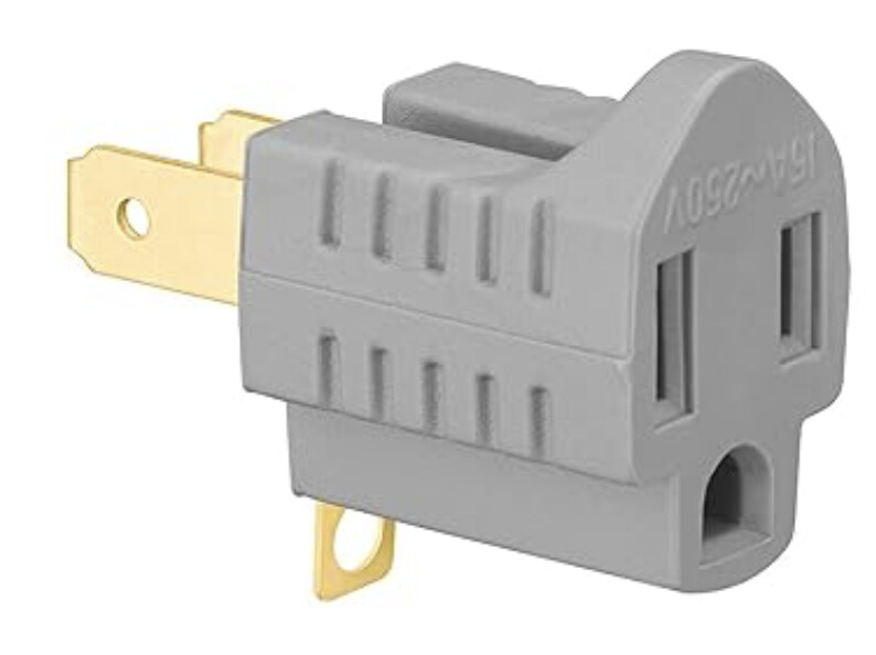

Try lifting the ground on the power cable to the PC, temporarily. Something else on the circuit could be the source of the noise. Alternatively, find all the devices supplied by the same circuit and power them off or disconnect.

Ground on the power cable? Circuit? Sorry, but I have no idea what you mean by that.
As for a component in the dongle being about to break; as I said, it does not make the electrical sounds when plugged into my phone (which is very noisy itself, when I listen to it with sensitive IEMs and an unbalanced cable I hear a noise floor, yet the dongle itself doesn’t make any noises)
Yes, ground connection on the power cable. The breaker or fuse and wire and outlet that the PC is plugged into is known as a ‘circuit’.
