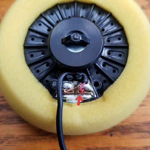

I did do 5 Kramer hole in the grille. Was careful not to let debris get to the drivers, but potentially and issue? Nothing macroscophic.
it’s def possible, it’s also possible that the cable is just getting janky since that has happened to me with the ksc75
I think I figured it out. Opened the plastic cover (rip one of the pins) and the two microwires were touching. The red insulated one has a bit of an exposed section (marked in the image) and that was probably causing a short. I’m guessing when I banged on the driver, the impact would shift the two contact points apart.
Been two days since I moved the wires away from each other and so far no issues. :confused:
can confirm this worked for me, stuck electrical tape over it so they wouldnt cross anymore, tyy :woman_genie:
