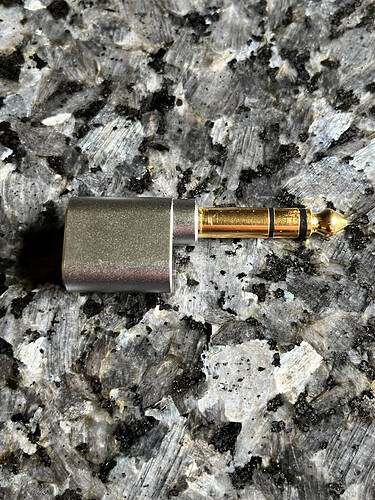

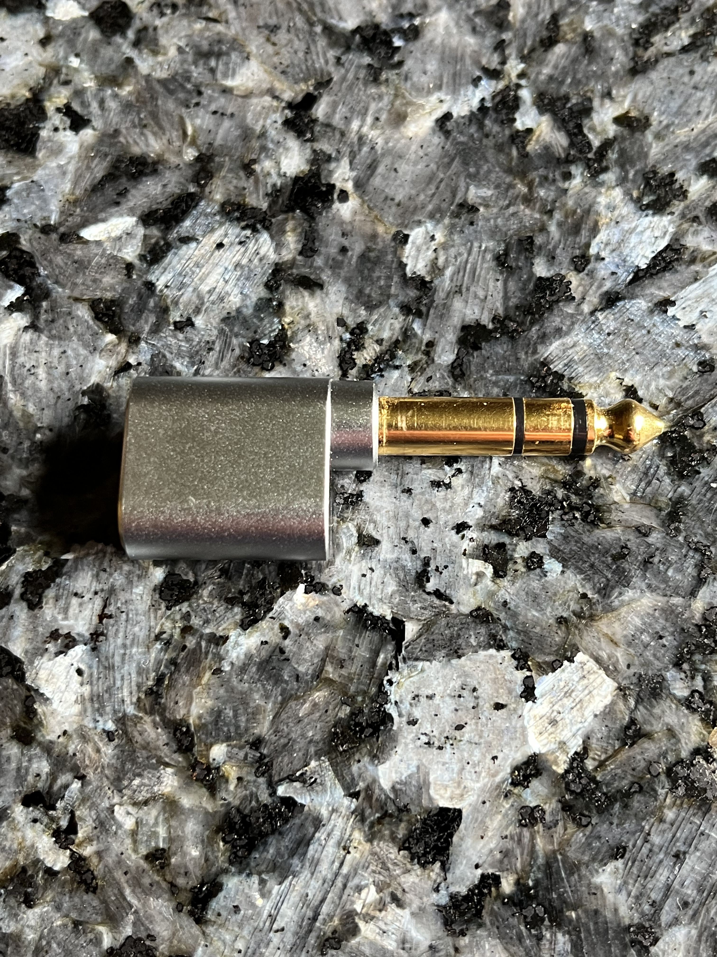

I can run my DX300 via a DD 4.4mm to 1/4 inch jack to my Little Dot MKII just fine I wouldn’t recommend going the other way…So I think balanced to SE is ok but SE to balanced not so…
DD 4.4mm to 1/4 jack
Correct. To clarify:
BALANCED (female connector) → SE (male connector) OK
SE (female connector) → BALANCED (male connector) NOT OK
