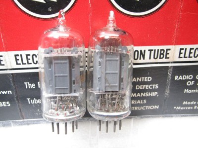

like @kcrack says its mostly the Bottlehead crack. There is a specific tube though that is quite sought out for being notoriously gooey I’ve got one in my collection, I’ll see if I can find it. and I don’t mean like rolled off I mean thicc
Found it, the RCA clear top. Very much loved gooey ass tube extremely thicc midrange for reference its a 12AU7 tube so its only going to fit on a crack not the Darkvoice but something to note if you end up buying it.
If you’re going to go for that tube I would also recommend trying studio grade E80CC tubes. They really are a huge step up and always fit with 12AU7 tube sockets [no adapters required] and can be had for a good price. See linked below
