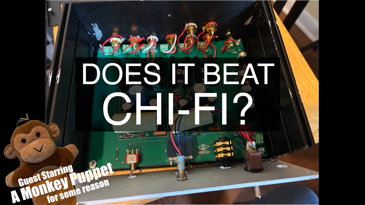

Hi all, made a video about my experience building an the Amp Camp Preamp + Headphone Amp designed by Nelson Pass, using it with various headphones, and comparing it to my Aune S17 Pro, including some distortion measurements and a visit from a monkey for some reason.
