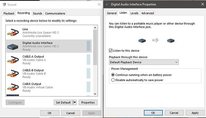

I don’t have my elgato on hand, but iirc it shows up in recording devices like my focusrite (shown below) does. You can set in the properties to listen to the device that is sending to the pc like I have done below:

I have an HD60 Pro and Avermedia HD2 i think and they both show up in sound properties similarly. so if u just want it routed to windows default just do what he suggested and adjust ur levels in properties.
