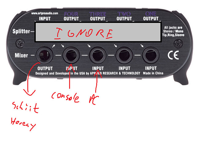

Cheapest solution would be a passive mixer like the ART SplitMix 4. It takes stereo 1/4" jack in and out (bottom row is mixer). So from the SplitMix4 to the Schiit Heresy, you would need a cable like this:
Yeah that’s what my setup looks like. (Blank box in the middle would be the splitter I linked with the RCA to 3.5mm cables)
So if I were to get that passive mixer, would I need to get three sets of the cables you depicted? (1 for Heresy, 1 for PC, 1 for Monitor). If not, how would incorporate the mixer with my current RCA splitter setup?
I appreciate the help and explanation!
Depends on what sort of outputs your console and monitor have.
They are 3.5mm, but I already have them connected with RCA to 3.5mm cables to the RCA splitter, which feeds into the amp
So I’m guessing I’d need three of those cables you showed, and just plug the splitter into those?
Either that (pay attention to get RCAs of the right gender), or you buy some 1/4 to 1/8 cables.
Should be about the same price wise.
Ohhhh okay!
I understand now, I won’t need to use the splitter with this setup (assuming I get the 1/4 to 1/8 cables).
So once it’s all set up, I’ll be able to set how much power/volume comes from each input?
yep.
Because it is a passive mixer, you may want to have the volume on your pc and console relatively high.
