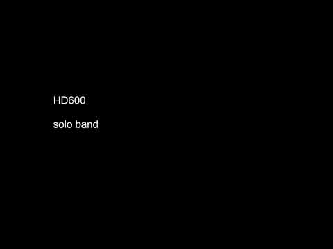

This is hard to explain so I made a video.
I took my condenser microphone and played a snippet of a song where the problem is really outstanding through the right speaker of the OLLO S4R and recorded it. In this snippet after around 3 seconds, a string instrument starts playing with some noise.
For comparison, I did the same with the HD600s. I ran the recording through a DAW with an EQ and amplified the frequency band where the noise is occurring for better comparison. Then I applied a solo band of that frequency to only listen to the noise. I also included the original snippet and a recording of the OLLO S4R without EQ.
This is not a comparison between HD600 and S4R for which sounds better overall. The S4Rs need a good seal to sound good which I can not do with my normal condenser microphone while the HD600s are much more forgiving in that regard. I made this video to compare the noise.
The S4Rs have much more noise and they add a very consistent frequency of noise. The noise existing in the original is rather random and spread out. In the video, you can see the noise by the S4Rs as the bump where the arrow points at. For me, this is noise that is added not just amplified. If it just was amplified it would look like the original just with a higher amplitude.
The HD600s look pretty much like the original.
