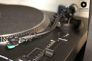

One cause might the actual tonearm cables:
It mentions “moving” but in your case the “activation” of tonearm starts the sound still might be from cables as well.
Issue 10: Interference When Moving the Tonearm
The wires inside the arm sometimes rub the walls of the tube, which in turn creates static, or they rub against one another which can also lead to induced current. This is more likely to occur in dry environments, so if you live in a warm, dry climate this could well be an explanation.
Getting into tonearm wiring is not as straightforward as some of the other fixes outline above, so unless you’re confident this may be one that is best left to a professional or at least someone with more experience.
10 common Tonearm issues.
Rest of the artickle
https://www.vinylrecordlife.com/record-player-tonearm-problems-fixes/
