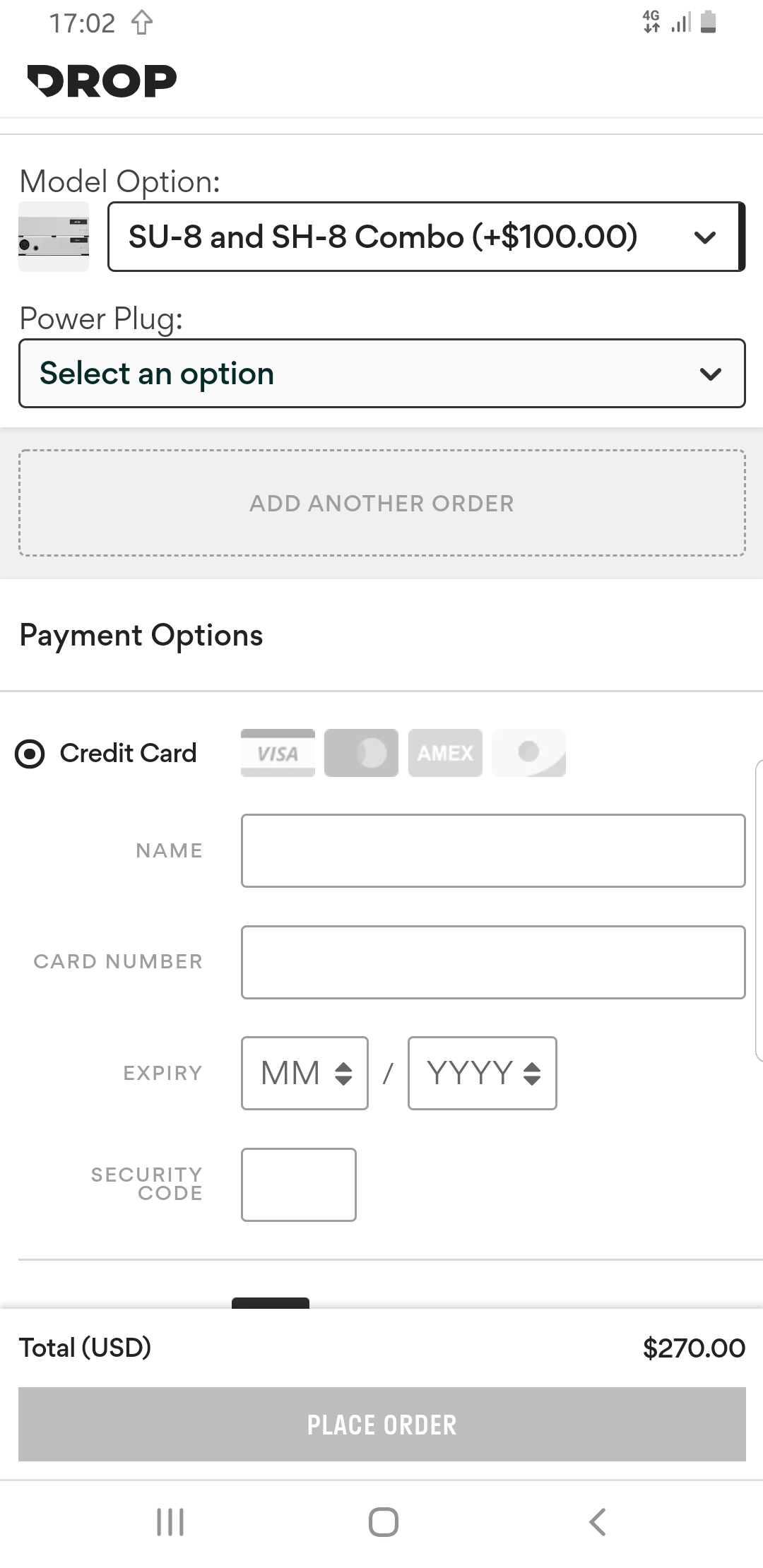

Thanx Guys, appriciate it. I see the SMSL SU8 / SH8 combo is now on massdrop for $270. Is it just me or is that a very good price for a balanced dac feeding a balanced amp?
I think that’s a pretty good price imo. I really like the su-8 v2 a lot, but the sh8 is somewhat mediocre imo. But at that price I think it’s a good pick (but you would want to have balanced headphones so that would add cost imo)
