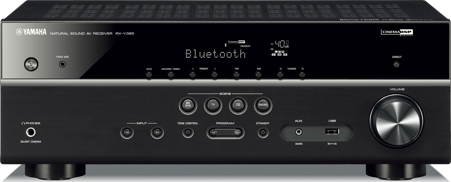

I actually was looking at the yamaha rx v385 since its at dell and i have credit there so i can add bigger budget that way, Would this or the Sony STR-DH590 be worth considering as compared to the pioneer that was recommended? Also would it still be worth it to add the DAC listed above to the set up if I go with the yamaha?

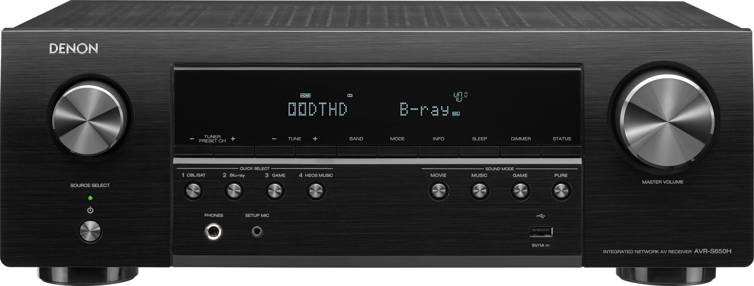

Many prefer Denon and Yamaha AVR for their menus , setup and room correction.
Dac- which Yamaha - any AVr or 2 ch receiver with optical input has a DAC in it. Analog 2 ch receivers with only rca inputs don’t have a DAC
