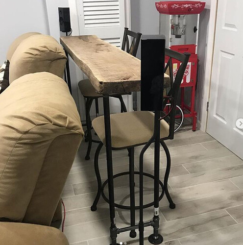

Added this table behind the recliners.
(those are temp rear speakers)
