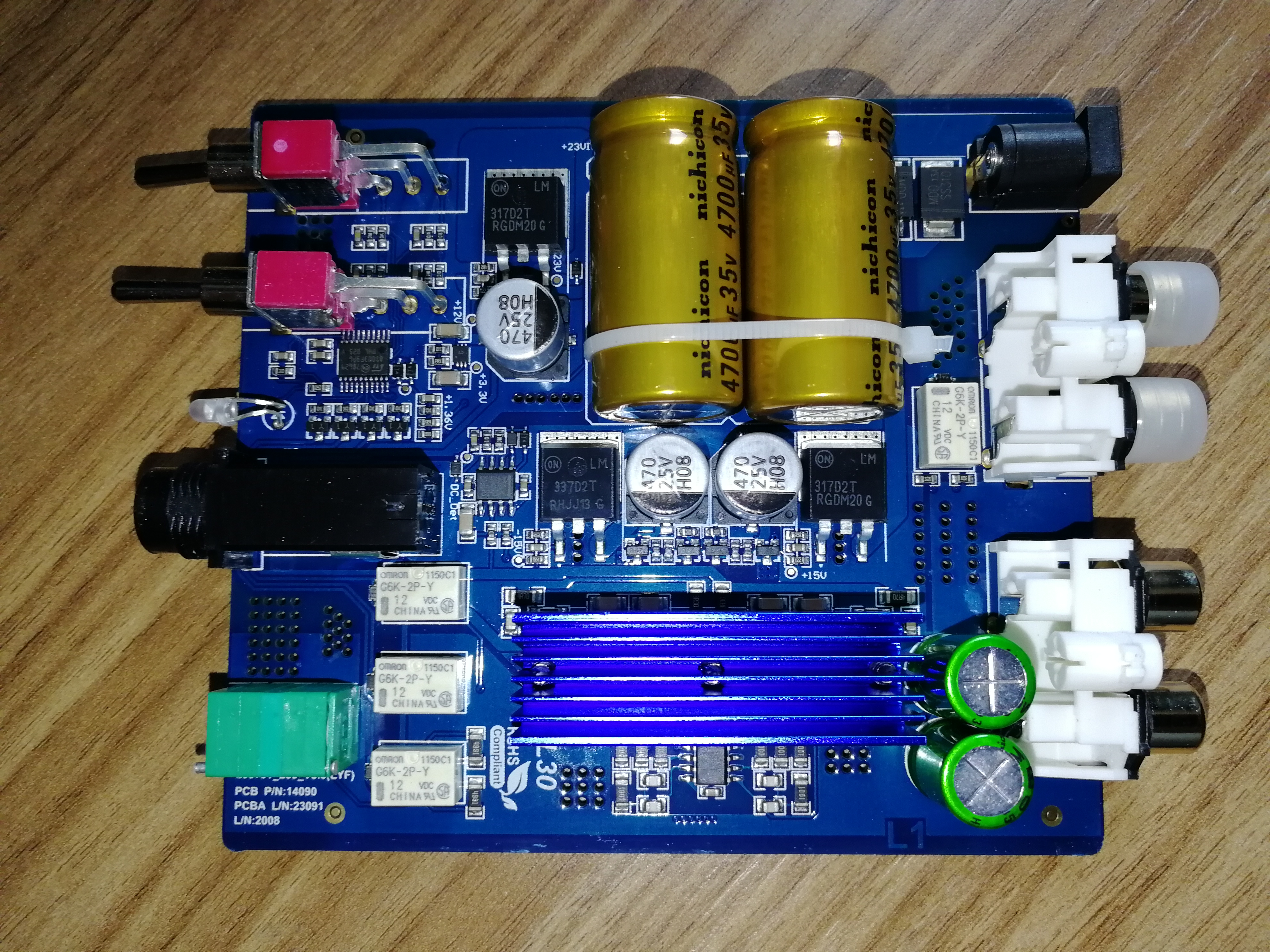

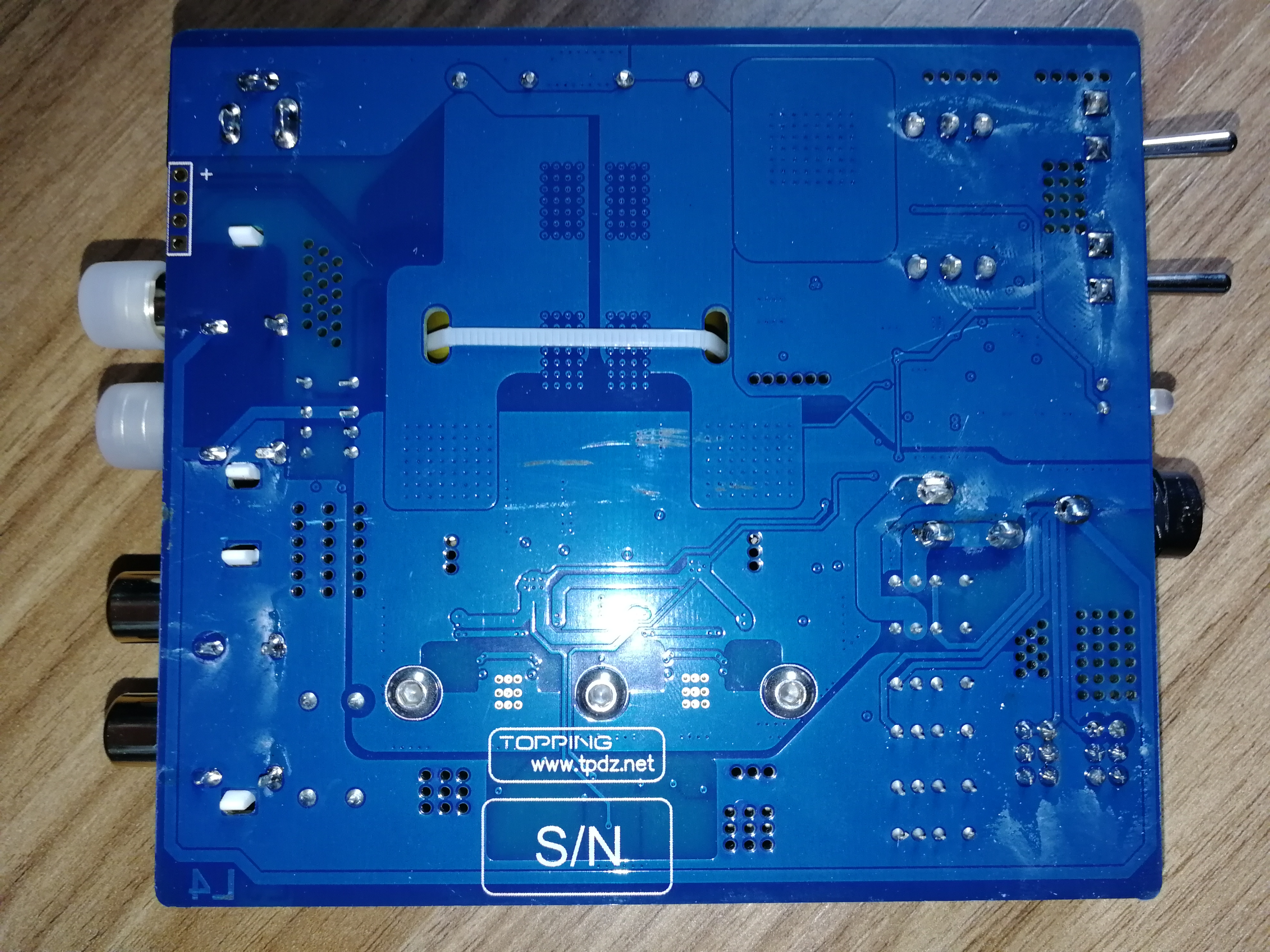

Hi all,
Wanted to let you guys know that my Topping L30 died on me. All of a sudden it stopped working for me on the right side of all my headphones (HD650, LCD 2C and a cheap one). The left side was still playing sound.
Tested all my headphones with two other amps I had and everything was working well.
Linsoul Audio-DE was doing well for me, they wanted me to destroy the unit I had before I get a replacement, so I got the chance to make photo’s from the defective unit. Now the wait until I get the new one, supposedly getting the 2012 batch.

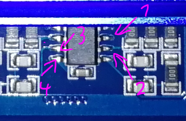

If you have a multimeter on hand, check the resistance between the arrows labeled 1-2 and between 3-4
Are you in Germany?
No i do not, I life in the Netherlands. I just bought the item trough amazon.de, it was better delivery time and price for me that way.
I will bring the L30 with me to work tomorrow, there i should have the multimeter at hand.
what am i looking for when i do this? @MazeFrame
Resistance between the pins.
That particular Op-Amp in the L30 is the one that takes a hit when ESD strikes.
