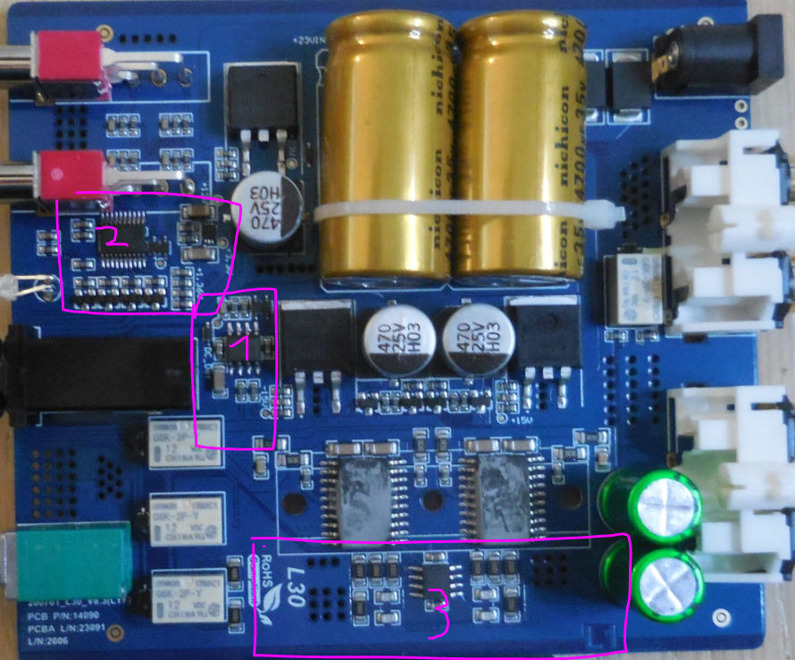

If you don’t mind, would you take one apart and post some photo of the internals? No need to remove parts from the board, just slide it out the case.
Areas of interest are these 3:
  1. A circuit marked “DC_Det”, if it does what the marking implies, this may be what changed.
  2. The uController the L30 has for some reason and some transistors to control the relays.
  3. The Op-Amp that (used to) blow up
gladly, expecting early next week

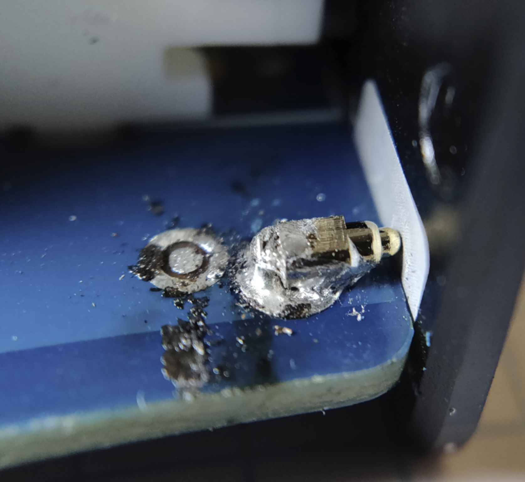

Here’s a pic (taken from another site) of the “fix”. A super shitty soldering job of a metal piece that sits against the chassis to ground it. Quality is job none at Topping lol.
Wow.
A freaking 5ct pogo pin to fix a grounding issue…
I’m particularly impressed with the soldering job. I hope it actually makes good contact or it’s going to be kablammo all over again.
It would be so funny to get reports of sudden “pling” noises in a few days/weeks when the bodge-joint fails and the pogo-pin pings about in the case :rofl:
I’m sure they needed to fix it without revving the board or the manufacturing process, an that was probably the easiest way to do that.
But that’s some pretty terrible soldering, so likely hand applied.

Respin the boards with a properly engineered fix. Bodging your way to success is… shit tier honestly.
Nothing wrong with a nicely layed out bodgewire. But that there? Come on!
Apparently it was done by one of the bean counters. Or perhaps HR. Because whoever did it has no business around a soldering iron. I bet 30% of those fail.
