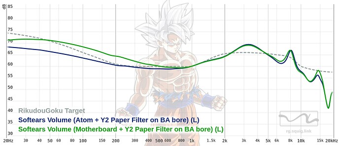

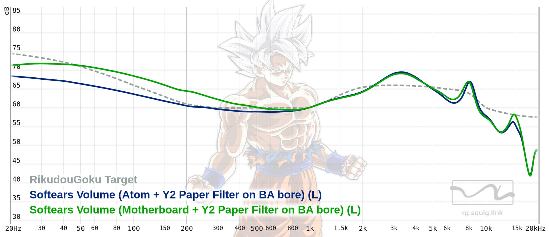

Modern motherboards are likely fine but depending on the age it may also be terrible. I know my old pc (12 year old MB) is quite terrible with the dac&amp in it.
Specifically it is the MSI Z87-G43, compared to the JDS Atom + Topping E30 setup.
