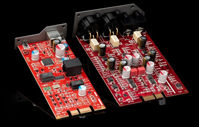

I’m curious how Multibit differs from those ladders cause this looks distinctly different
For me the issue is Shipping and exchange rate. I want that new version of the denafrips terminator and the Yggdrasil but exchange rate, Customs all will kill me
In a multibit DAC, the resistor ladder in inside a chip, as opposed to being surface mounted resistors.
All early DAC’s were multibit, DS DACs came later.
Schiit use multibit DAC’s intended for medical devices, because no one makes audio chips that way anymore.
Companies like MHDT/Borderpatrol and others use discontinued audio chips from Philips, TI, Analog Devices etc. with similar ladder on chip based designs.
Wow, you shoot high! I would be happy with the Ares II.
Those are the USB input board and the signal output board. One comes before the DAC, the other comes after so there’s no DAC on this picture. My understanding of Multibit is that they are just super tiny resistors on an IC. But I may be way off.
So, it’s performing the same behavior but on a chip? Or is it fundamentally different and results in a qualitatively different sound?
The ladders are basically the same, the version on a chip will probably be more accurate, because the required resistor tolerances for each additional bit get tighter and tighter.
The chips usually guarantee 1/2 lsb accuracy, I doubt any discrete solution gets close to that for the same bit depths.
I’m guessing it’s the flat square chip just south of the 2 silver caps below the phone jack.
The actual DAC are built in chips.
The DA converters are labelled U6 and U7 in the right hand board on his first image.
They are a part of the analog board int the Bifrost 2.
Oh! Interesting. Thanks
You’re right, they’re the AD5781ARUZ - you can see it if you zoom in on the chips.
