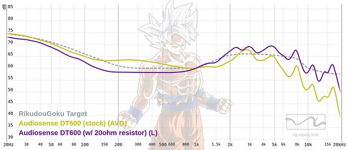

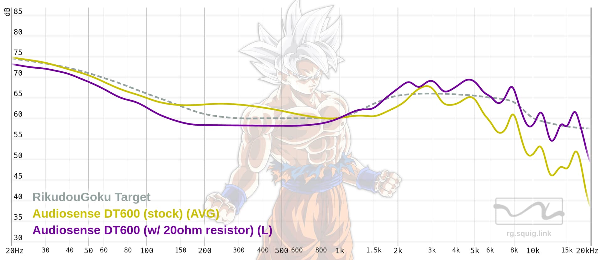

That is not always true.
Depends on how the impedance curve of the transducer itself is like.
Example of the opposite.
