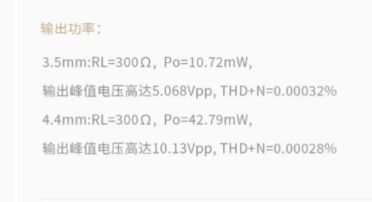

Oops, the power plot thiccens.
Did you find by any chance the 15C was able to push 2x the power on BAL-out vs. the 15i?
