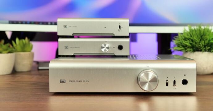

Looks like the silver E30 is made for the Asgard, heh. :slight_smile:
I agree! They look gorgeous together! Sometimes I stop what I am doing just to admire my stack. =)
