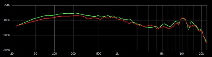

Fiio FH1

Forgot about Fiio. Found a graph for Fiio FH1s. Nice!
