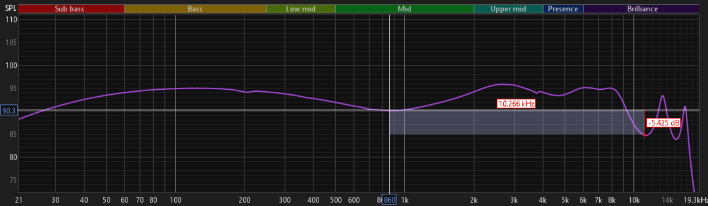

Full disclosure: These are not the OG DM drivers, they are either a revision or a copy and I will never know. Likely they have a heavier mass diaphragm OR voice coil, either way, this causes the resonant peak to be lower in frequency, around 2.2k which is a shoutfest. I’ve spent way way too many brain cells and time trying to fix this crap. I have a lot of drivers too so its either make it work or shit-can the project. I’m trying to not shit can it.

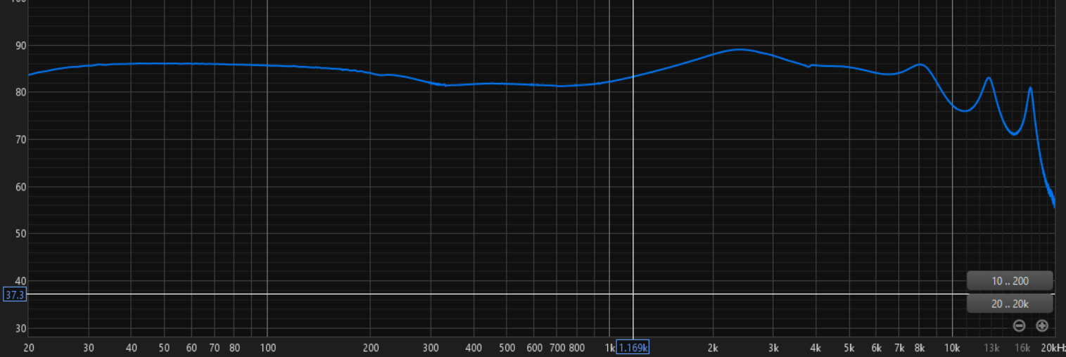

I have been talking to folks with a 5128 rig and all I have is a 711 which has incorrect acoustic impedance vs an actual ear canal.. and the 5128 is supposed to be much better in this aspect, so I created a compensation for below 1k frequencies based on known IEM measurements on both rigs. It’s pretty minor but helps me get an better visual idea of what I am hearing. Anyhow, here is my latest tuning which includes much better over 10k energy, approximitely correct ear gain and enough midbass and subs that rock and metal does the thing, which is like half my library.
This iem will not be released until it is perfect or maybe not at all, but I’m still trying.

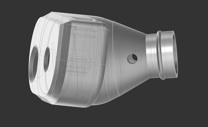

Anomaly is actually open back. No messing around, there is a micro gap where the DD is press fit into the shell. The back of the driver has has extremely low damping and is enough combined with the micro gap to make the back of the iem make sound enough to annoy other people and also allow in sound from the outside. I am not fing around with this, i want this iem to be actually as open back as the tuning allows. Having said that I have tested ‘open back iems’ which are faking it such as the Kiwi Ears septet. Using a Piezeo firing out the back shell is bullshit and MAYBE it allows some sound to transmit to the nozzle, im not convinced its enough to actually be enough to matter.
Less is more in this case. I don’t have it perfect, and I doubt it can be perfect but im doing my best to make it happen.
The only way to have this work right is to give a healthy midbass/sub shelf. I wish I could clean it up but acoustics dictate it has to be this way.
Anomaly has 2x (yes 2!) 1.5mm vents on the front bore. The driver is not sealed and has a 0.1mm micro gap. Aint no back waves fucking up my mojo.

[edit] I just woke up. What IEM are you talking about? Mine? It has no driver seal, 2 big vents, you cant really block anything enough to make it pressurize.

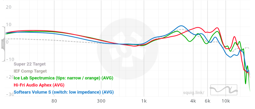

Most IEMs released these days have no mis-bass. Such a shame. My favorite IEM I ever demoed was the spectrumica and it HAS mid bass.
Edit: here are some have favorite IEMs.
