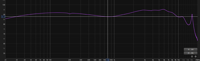

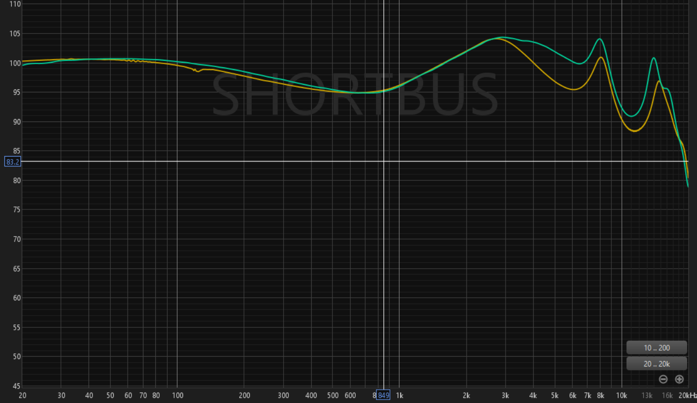

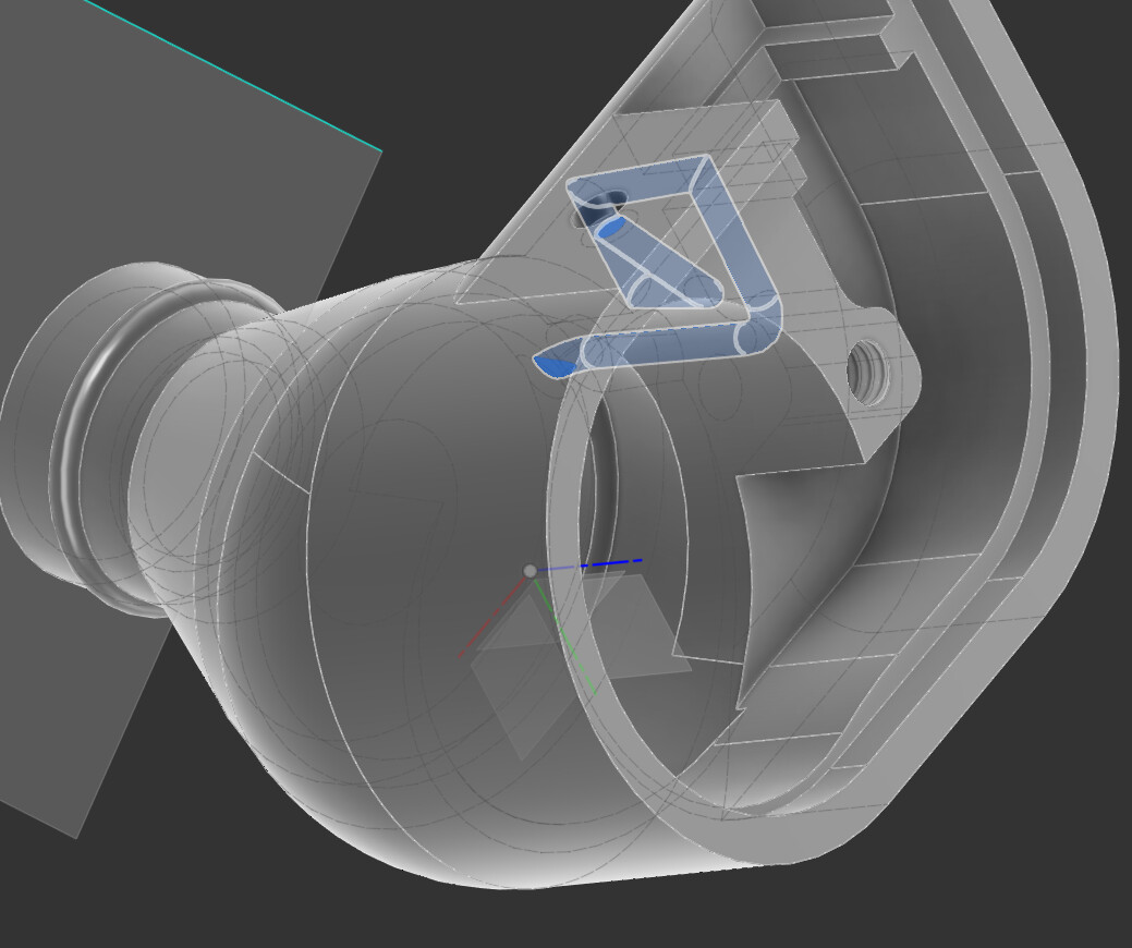

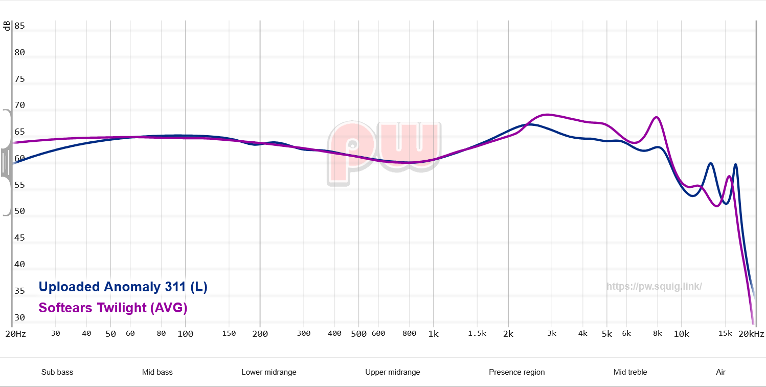

We are on set no 311 (LOL!). I added a previous feature which is a snakey vent at 0.65mm and about 12mm. What this does is basically turn down the midbass and increase subs which cannot escape the vent length so they are captured. Midbass sees less impedance and gets diminished. 7db ear gain, linear treble, -6db over 10k give or take as a coupler can be wacky
311 that’s crazy. I remember the tubing from an older version. Do you feel that you’re getting into endgame territory, i.e. close to finishing it?
I can’t say until all the factors align, IE, super staging AND FR that means business. So far I am not satisfied. Im treating this like a set I would review. Either it is amazing or it isnt, and I wont release something subpar.

I haven’t updated in awhile, im here.. which is perfect mids to treble. Im unhappy about subs, but the rest is full TOTL insanity. So so very close yet so far.
Your dedication to getting it perfect is impressive. Hope you’ll find a way to remedy the subs.

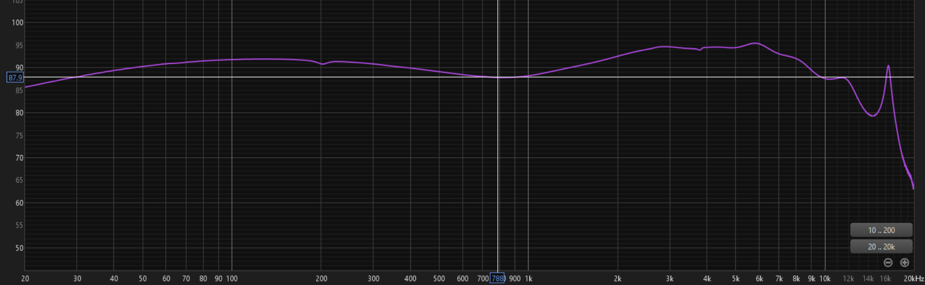

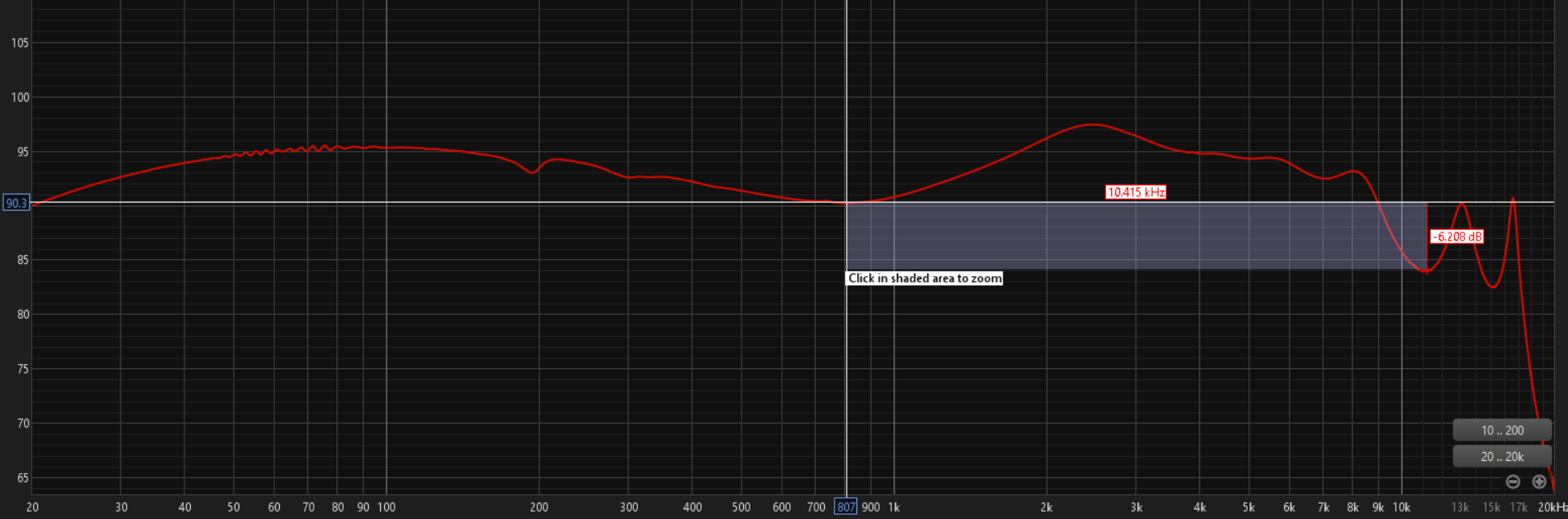

I gotta ask for some help here. I have an issue with the clone 711 coupler (s) that I haven’t been able to figure out over the last few years and I’m about to go insane. I have to get this fixed..
Take one iem which is the Tanchjim Origin and is PaulWasabi’s personal pair which he measured. I got his iems to review, did a graph and WHAT THE F#$@
Here is my signal chain in case it helps:
PC Realtek Microphone ‘IN’ on back of PC → 711 clone coupler via 3.5” jack
Room EQ Wizard with no compensation file loaded
IEM plugged into a Radsone ES100 via USB from the same PC.
I made damn sure there are no effects on the realtek mic input, so no echo cancellation or whatever else. I then cross-tested on a different computer which is a MS surface tablet using the USB Black box everyone uses from Aliexpress with the same 711 plugged into the mic input.
Both setups give the exact same graph which is the yellow one. Im literally at a loss and I’ve already purchased ANOTHER 711 and tried it and it did the same damn thing.
HELP! I need this measurement rig to work for christs sake.
Strange. What does Paul use? Try to copy his setup maybe?
I’ve asked him before but I’ll give it another shot.
No chance of any clogging or debris in the nozzles?
