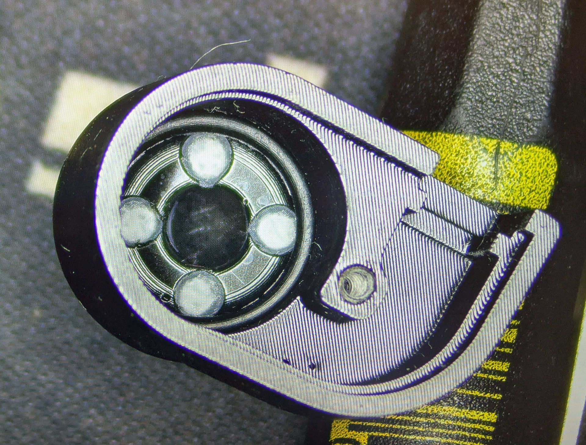

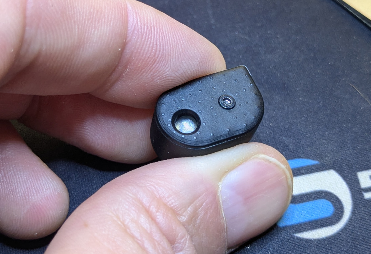

New tech (or something). We got the 4 1.5"mm front chamber vents, as shown. It’s a little hard to see, but I got some custom silicone O-Rings, and was able to make a channel for them to fit exactly perfect, so now the spring setup works perfectly for a full air seal. The point with this is to allow anyone to completely mod the IEM, remove the driver, replace it, change venting, etc. Literally everything.

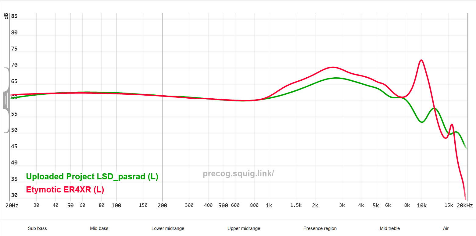

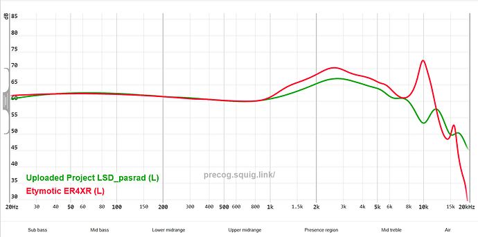

and a graph:
Not freakin bad at all. Stage swirly 3D is nearly maxed out here, and I retained enough subs to make me non-upset.

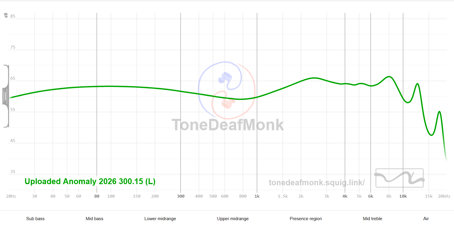

That took me like 2 minutes to try.. Been on my mind for awhile. Not sure but it certainly does a thing. Also that is not Anomaly, its project LSD (letshouer drivers).

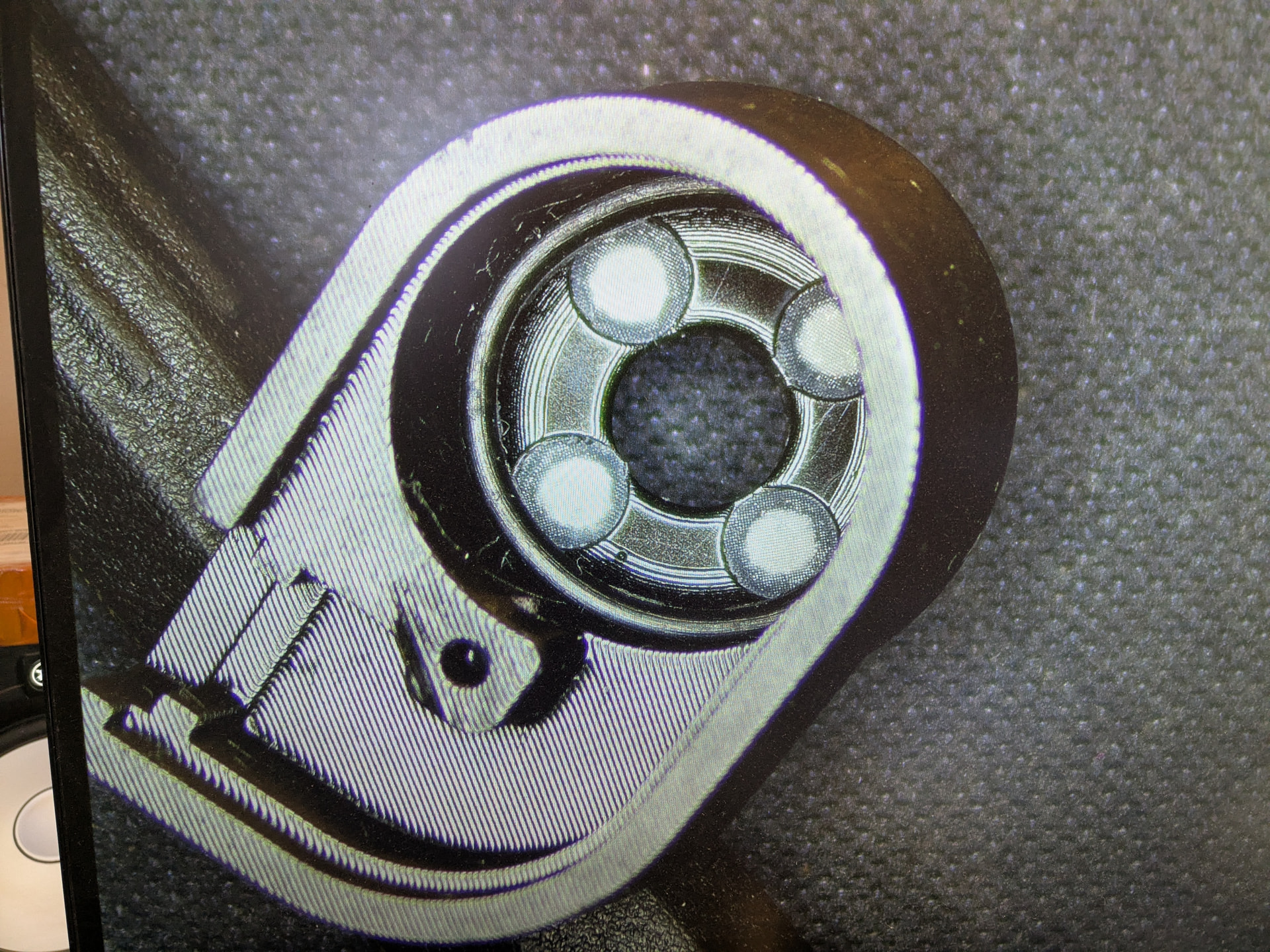

Been refining the BIG VENT™ idea. Today I nailed a balance that really doing it for me.
Idea 1: Twilight does not have nozzle vents, lets not have those and see
Idea 2: Bass and subs are just not doing it for me with 4x 1.5mm vents and if i put on the highest value dampers, it basically makes the entire feature not work. Lets decrease to 4x 1.0mm and try again.
Idea 3: The potato PR I made works really well actually, might have to spend a minute implementing it better
With these refinements (1.5mm x 4 vents → 1.0 x 4 vents), no noz vent (which were another 1.5x2), move the damper position closer to the driver, and shrink the nozzle by 1.5mm in length, im hearing some extreme magic. THANK GOD! It’s a lot like as if Twilight got its drivers replaced by the Dark Magician.
