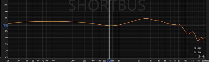

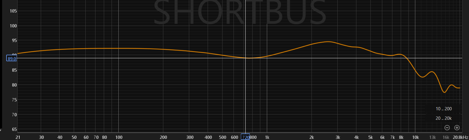

Allrighty. Refined the micro-gap and the shell a hair.
As far as why I think this is very close to real open baffle is this: the driver is not actually sealed inside the shell, there is a microgap which was quite hard to dial in. The driver diaphragm has about a 1mm baffle around it, and since it isn’t air sealed, you get much less shell-front-volume resonances and the air in front of the driver is still coupled enough to make subs . The sound can in fact flow around the driver and out the back of the shell (vent).
I’m in the mood to try tracks and give an impression. I really think I have everything nailed.
I suppose if people wanted to they could post a youtube video/music they really enjoy and/or think is hard for IEMs to replay. I’ll report my impressions. Don’t hit me with too much though. maybe 3 tracks if you feel like it.
we are working with this graph, which should be pretty accurate how I hear it
