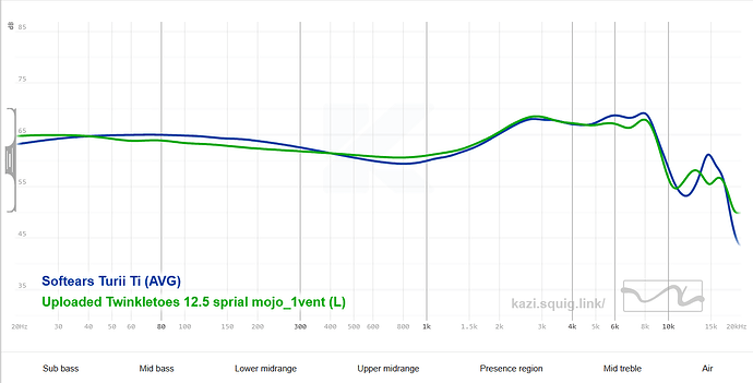

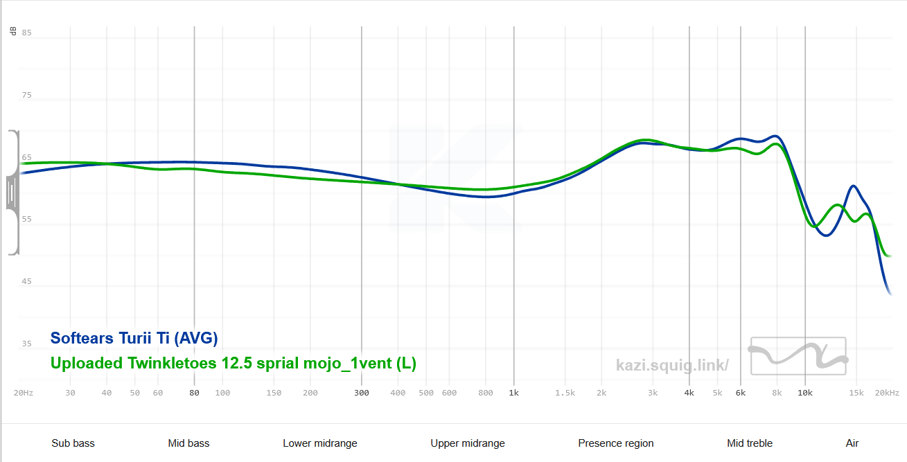

Yep! I undershot the size of the vent, still it works perfectly.
doing some relaxing saturday tuning, sniffing the (farts) tunings

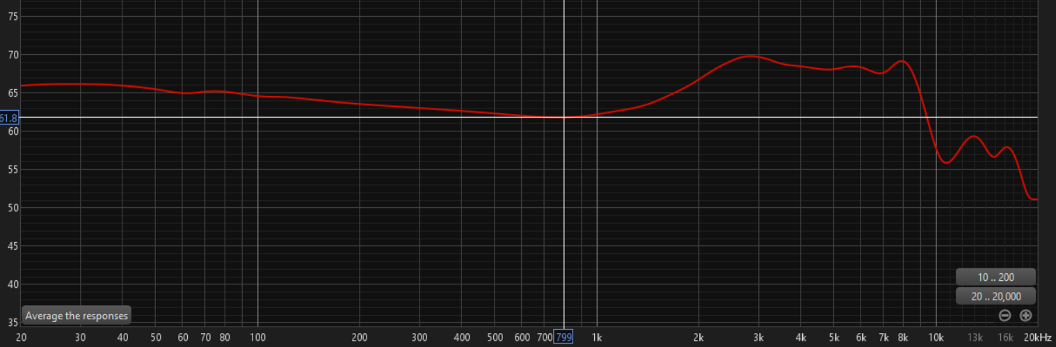

I see I say I say I see! Did you already test those tracks with that big boom tuning already too? :slightly_smiling_face:
not yet, I can try now, i had massive issues last night, red ants and everything
[edit] this is not your droid, Dave. This is for extremely well mixed fart sniffing music. Sorry about that.
And this is with the big booty boom? I appreciate you doing that man :blush:

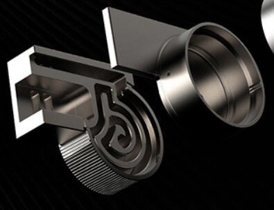

How do you print those tubes, I barely get them printing even with a 0.75mm x 0.75mm area tube. Also for that exit to work, the rear volume has to be sealed to that tube right?

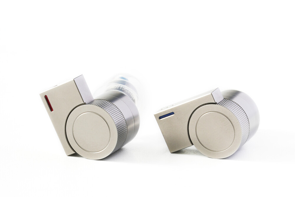

Isn’t that Softears EDGE?
It is. Wanted to ask him about it, but like he said, he already discussed it in his latest vid.
That shape sure looks like the Softears EDGE.

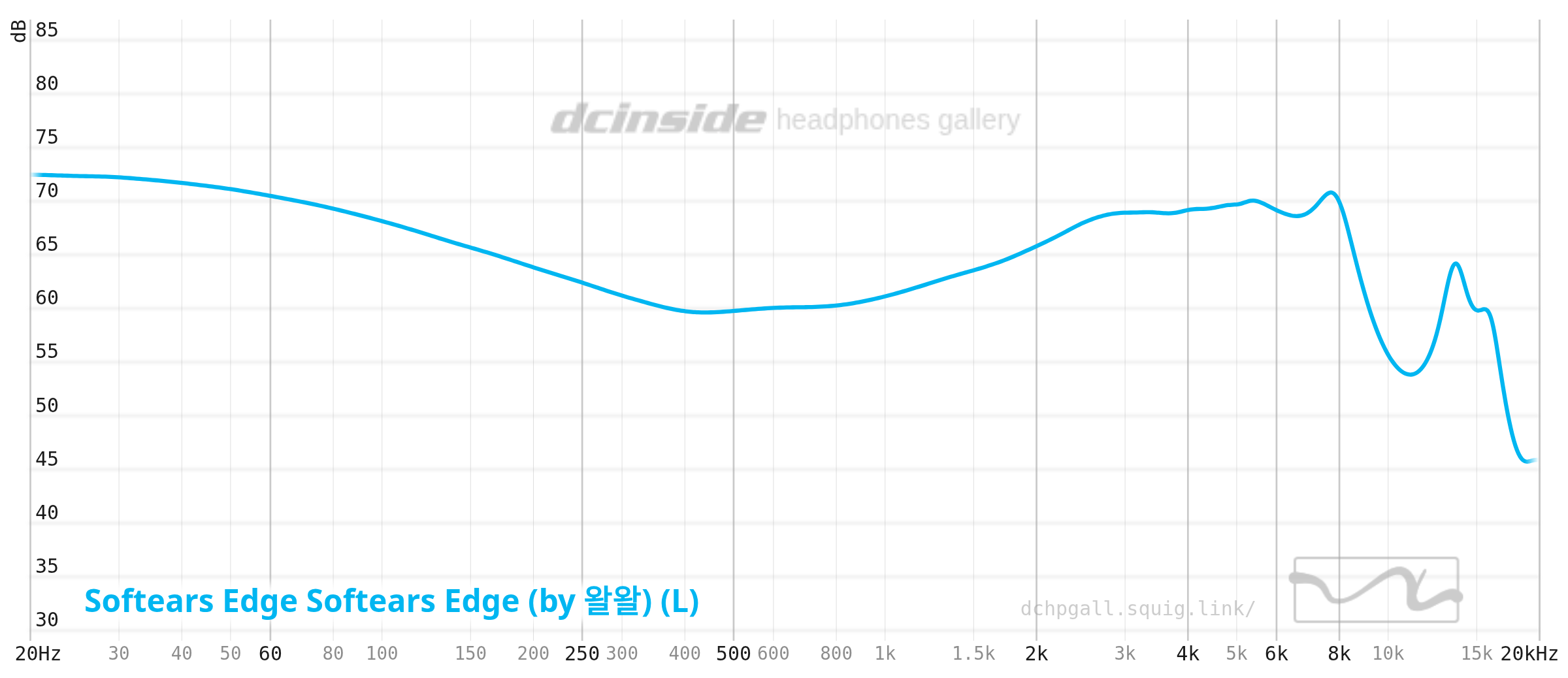

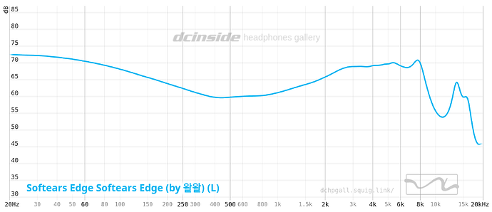

Thats pretty bassy from a softears iem.

Yeah Softears Edge. How I printed the channels is by using black resin, not clear. I then have to make a place to insert a syringe filled with 99% iso and blow out the channel with it a few times, ultrasonic, blow out more, then with air. I can print down to around 0.4mm holes/channels but I have to be quite careful.
haha, what the fuck?! shakes head Form over function for sure.
The tubes worked to a certain extent in my case, did the same, inject Iso and all, but there were channel balance problems across shells, and I had tested the drivers before and after. Having channel balance problems, i decided not to continue there…
I suspect you need a super good printer to pull it off. I use a Uniformation GK2 which is good and I know Thieaudio uses them as well as other manufactures.
