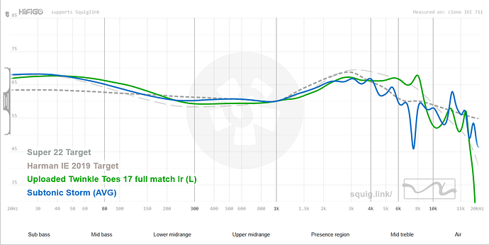

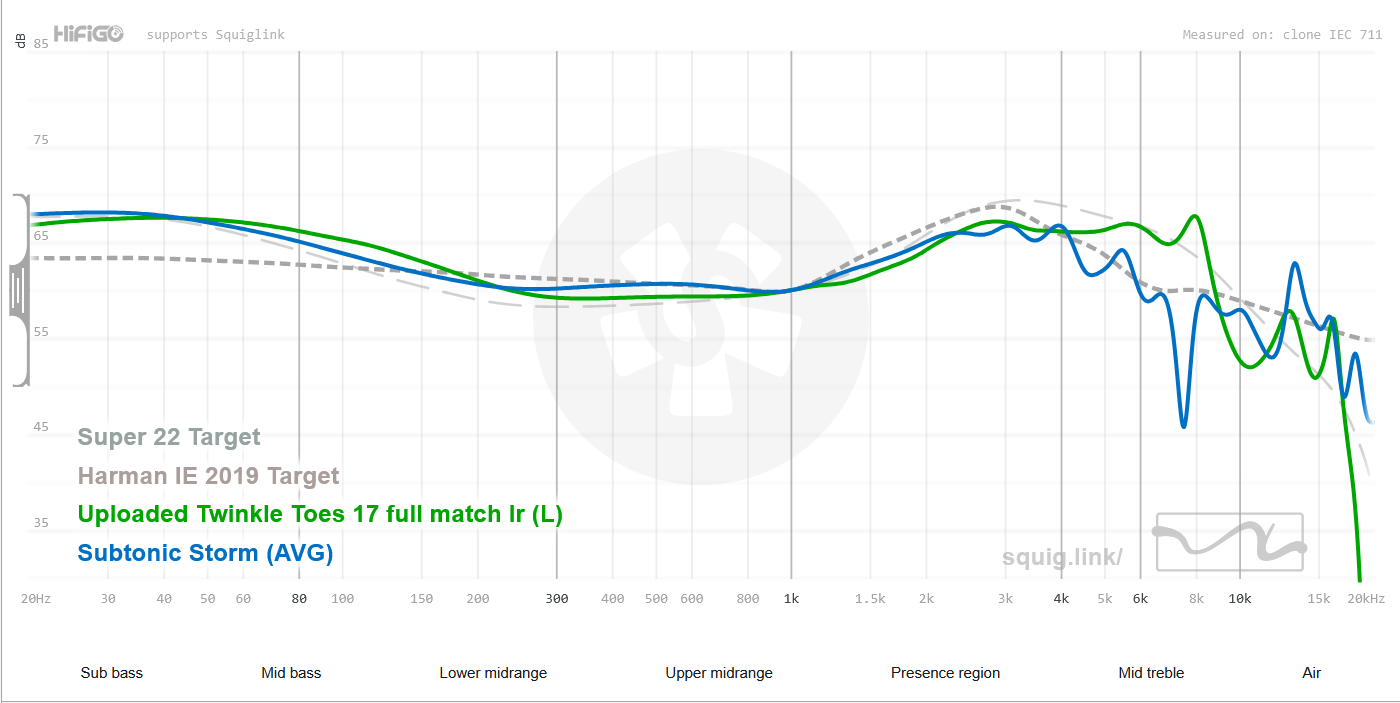

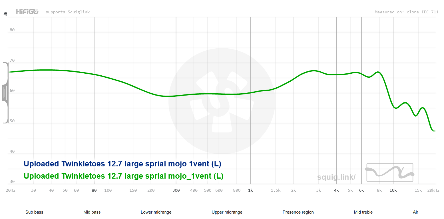

Fwiw, here is the unnamed set formerly known as Twinkle toes and it is FUCKING DONE BABY

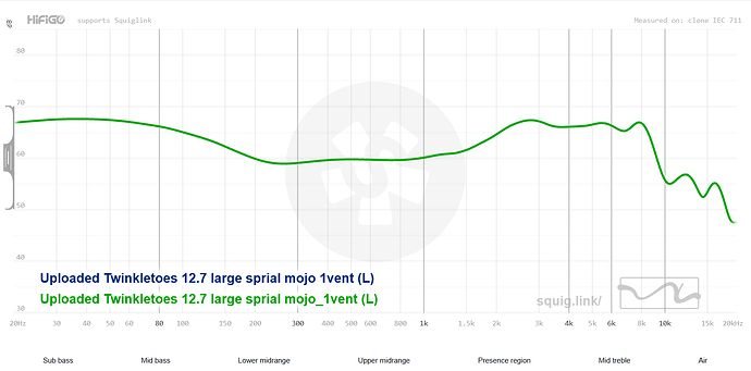

Im open to suggestions on the bass shelf. Basically I can vent more and that is the option. More open stage vs subs.

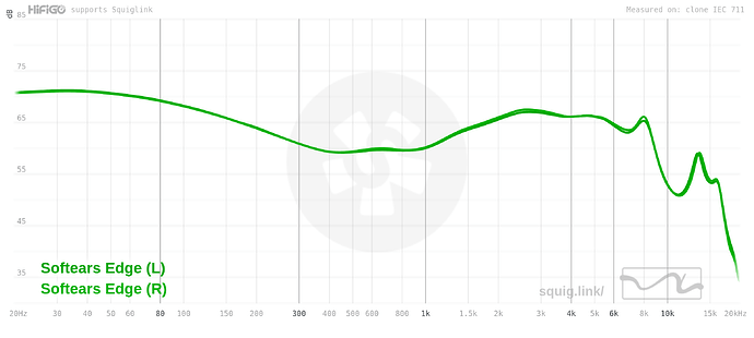

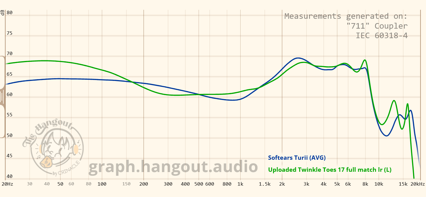

Also can anyone find another 1DD set with this kind of graph?
The Edge is the most similar i have seen at least with the bass shelf.

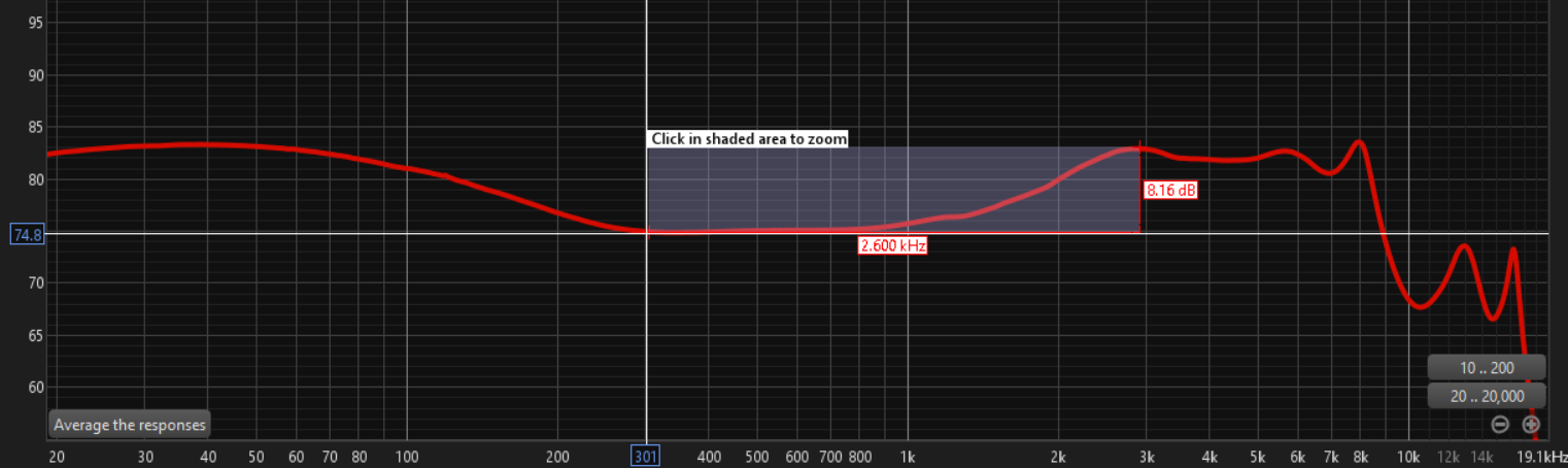

Cool, I think I out did it in terms of ‘clean’ mid shelf. IM cutting at 250hz (or 200 if i want). I like 250 because Im a slut for bass.
The Twinkle Toes graph kind of reminds me of the OG Kefine Delci. The 8 dB pinna gain is my preference and 2 kHz is very slightly scooped instead of a straight line pinna gain. The bass shelf should be a lot of fun if this IEM delivers very clean details.
