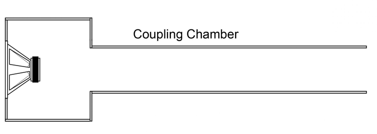

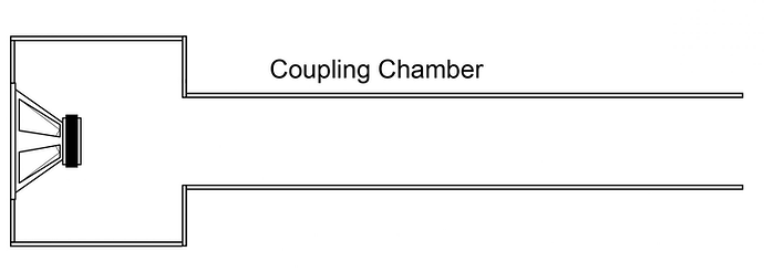

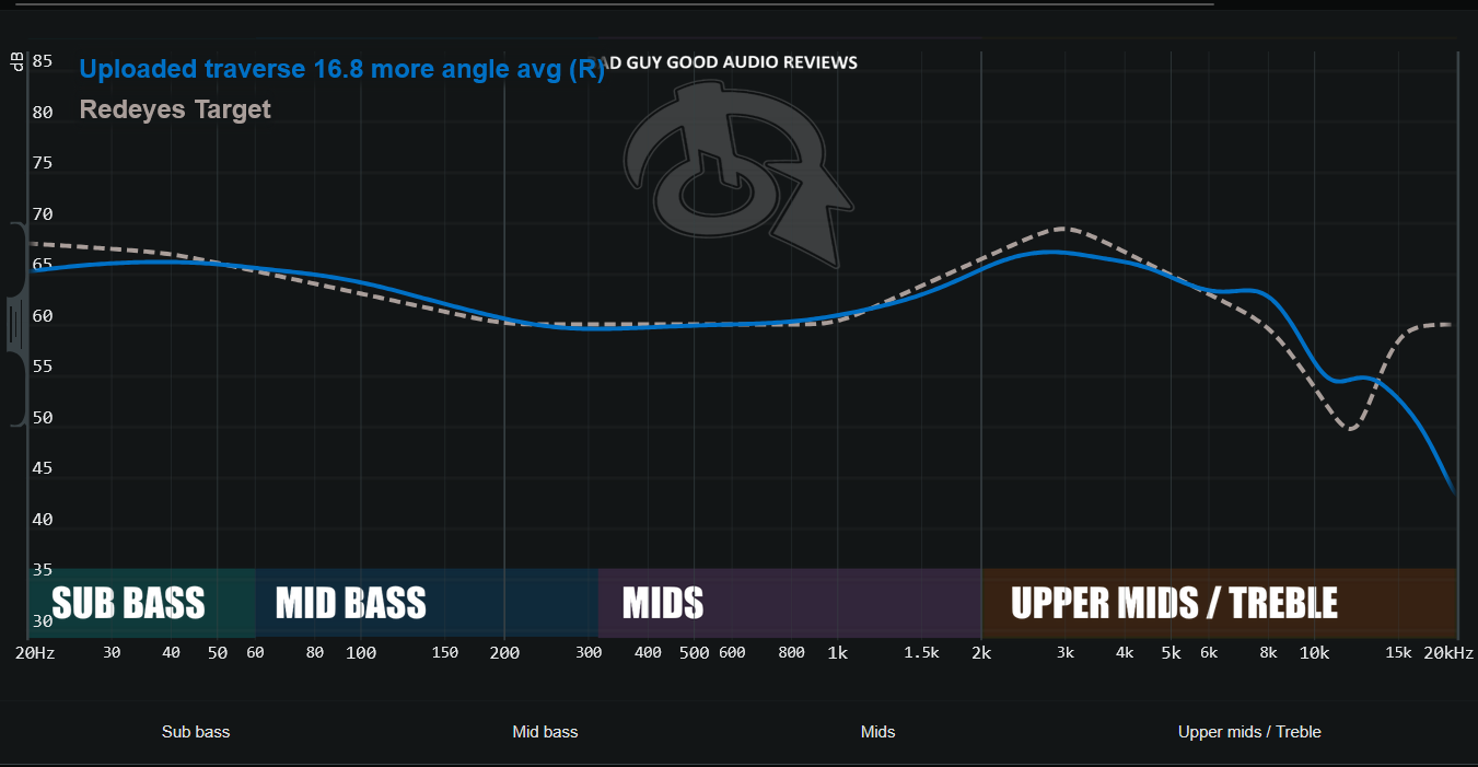

Trying to illustrate how Traverse is tuned, this last image is correct. A buffer behind the DD in space and air volume leading to a long 5.4cm transmission line vent. You can look at the graph to see how this works.
Please comment and go nuts. Much love to anyone that cares and posts!

Looking slick, cool to finally see the project materialize. I fell behind on updates, so I’m behind the curve. The new FR looks great, super smooth.

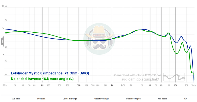

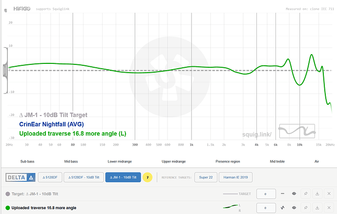

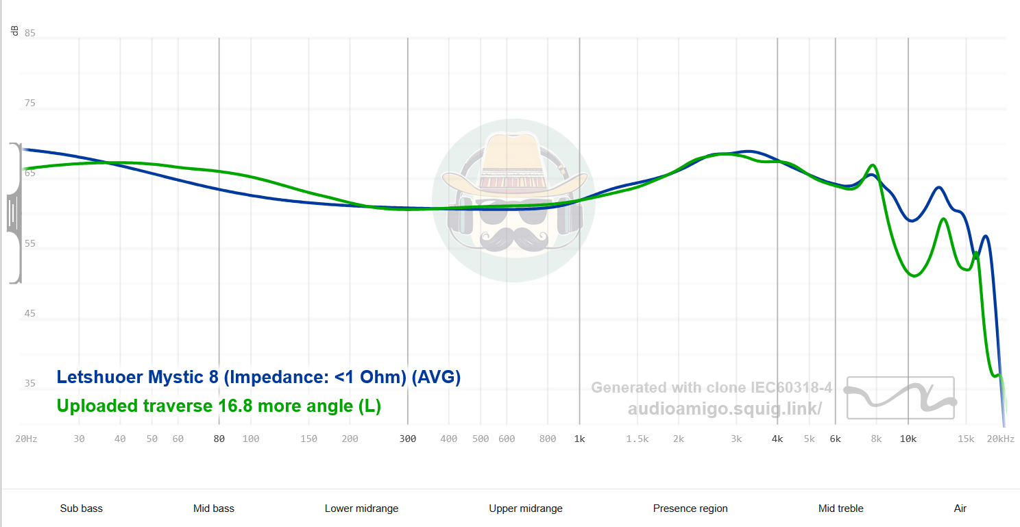

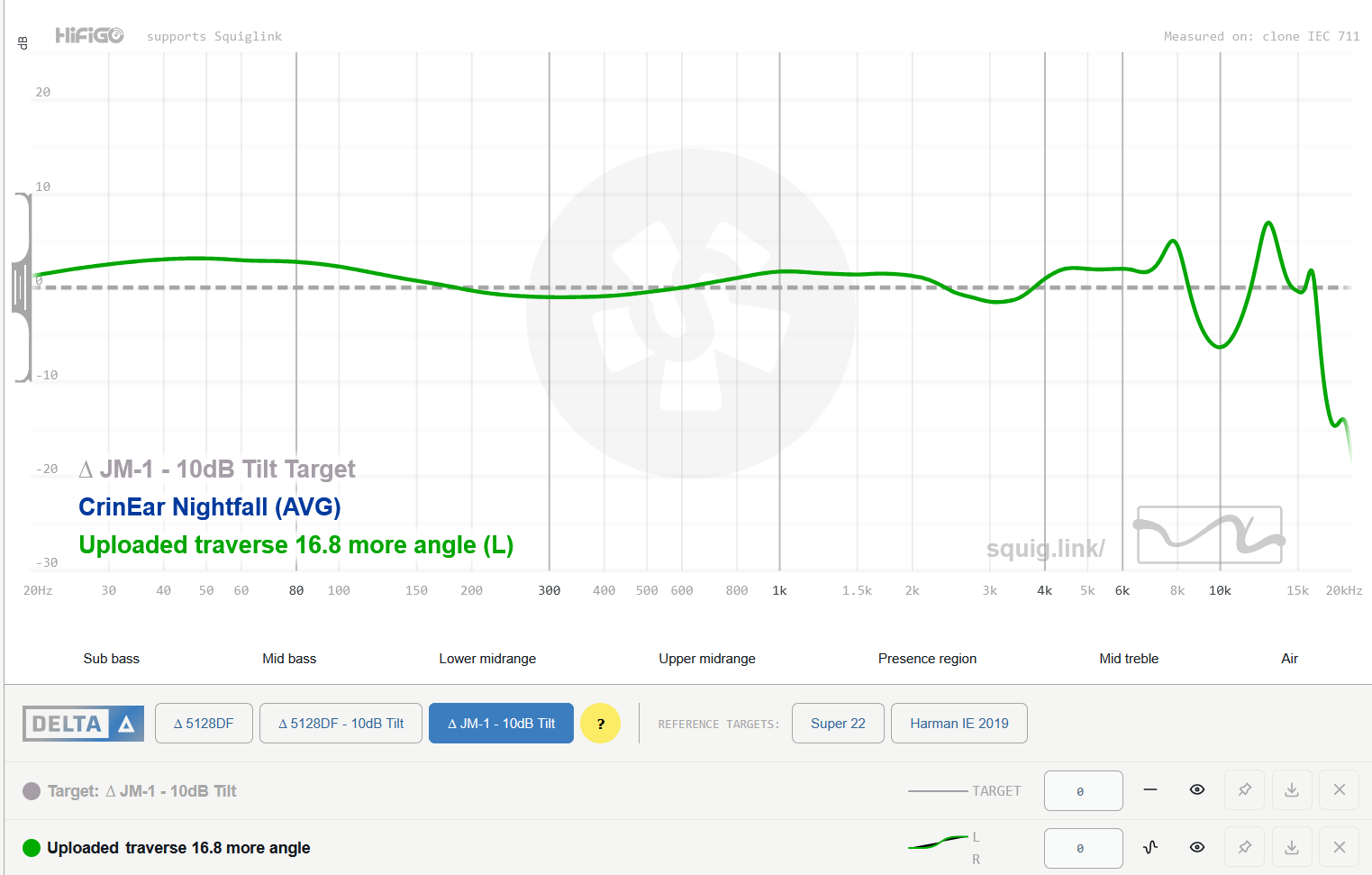

Also: some folks were asking me wtf the tuning is like, ie, W shaped, V shaped, U shaped, etc. When you ask this kind of question you need to do compensation so it lands similar to this:
Barely a W perhaps? Thats gotta be the closest.
I gotta say this directly: There are ZERO iems on the market with this graph and the bass being handled by an 11mm tesla super strength magnet. Is that worth something? I think so.

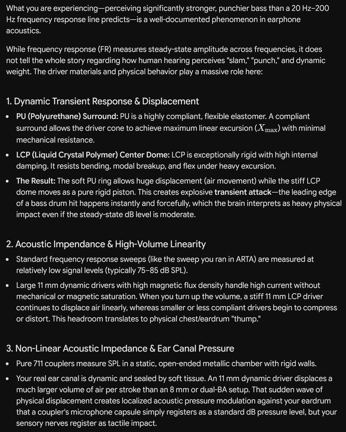

Something that has been on my mind is why does this iem sound so so much thicker and bassy than the graph shows. All I got is its an 11mm driver with big ass magnets. Decided to ask the dreaded AI just to see, because googling this is driving me fucking nuts. It came back with this
I told the fucking AI not to blow smoke up my ass and just give me the data and then told it to be in Hal 9000 mode since that is a good ass robot.
