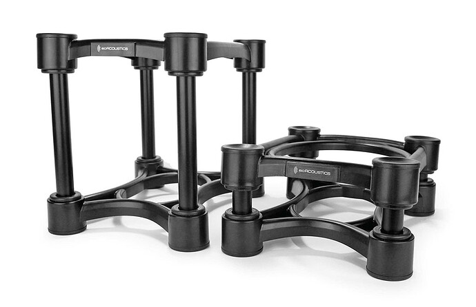

I stuck these under my Neumis:
They fit the enclosures perfectly and puts them up 2 inches, just right for me. They took nearly all the vibration away from my desk. Changed the sound slightly as well. Bass is not rumbly now, it’s more focused and precise if that makes sense. I really like them. I may try stands in the future to see what the differences are if any.
