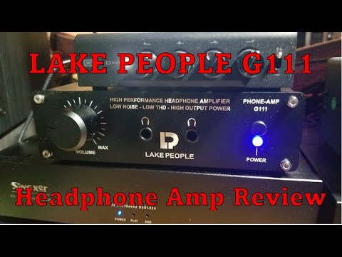

Fwiw I have the Asgard 3 and recently got a G111. Definite step up in every way. I’m using it with the BF 2 OG.
@WaveTheory has a good review of the G111 mk 2, in which he compares it to
the G111.
Relevant links.

I have not heard the iHA-6 or Flux options yet. Of those I’ve heard the G111mk2 sounds like the best match to your cans and stated preferences. The Lake People design is very strong for hi-Z loads which is most of what you have (Elex is sorta mid but Focals do well on Lake People amps). The only downside to the G111mk2 for you might be it’s not quite powerful enough for something like an HE-6 series can. But if you don’t have any desire for one of those you should be fine.

The Vio V200 series will be the next step up. To my knowledge the Lake People line tops out with the G111. The V200 line will be more resolving and holographic but also warmer. The Lake People sound is more studio neutral, because they are meant to be studio headamps. Both will handle most planars well also. The G111mk2 drove my HE1000se splendidly. The original G111 handled LCD-X very well too. My Vio V281 does fine for HE6 and is decent with Susvara but you’re better off jumping up to the V550 for inefficient planars… At a cost of course.
