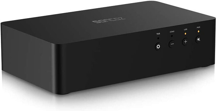

đź”· Soncoz LA-QXD1
This is the official thread for the Soncoz LA-QXD1
  • USB, Coax in and out, toslink input, xlr and rca output
  • ES9038Q2M, 32/768kHz
  • Adjustable volume
