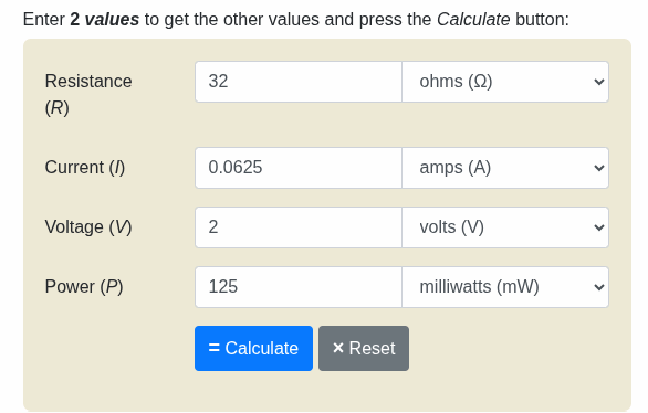

Which if they are using the standard way to measure it which would be at 32ohm, it would mean it has 125mw@32ohm

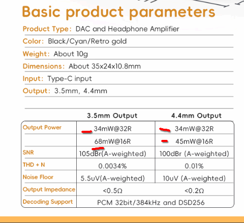

Another example with more transparent specs would be the stuff from fiio.
Although strange that the 4.4mm is weaker, maybe a typo…

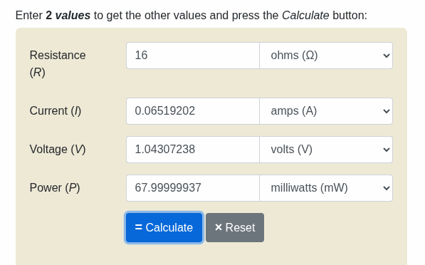

but 34mW@32ohm and then 45mW@16ohm is an example of the current limiting. Cuz if it converted linearly it would be 68mW@16ohm

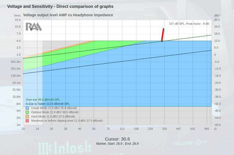

This site is also good to check.
They dont have the dc4 u though but dc4.
https://reference-audio-analyzer.pro/en/param5.php?&idmain=3089&chanell=2&splm=107&hpsp_v=110&hpsp_r=50&hpsens_v=110&clhpsens0=%231B415B&clhpsens1=%231D711D&hsn0=In-Ear or Tablet&hsn1=Over-ear&idmain=3089&id0=3089&hss0=112&hss1=99&hst0=1&hst1=1&report_page=1#gsc.tab=0
  • Output Power 195mS @ 32 ohms / 4Vrms @300 ohms
4vrms at around 300ohm but at around 32ohm it is 0.5-1vrms
