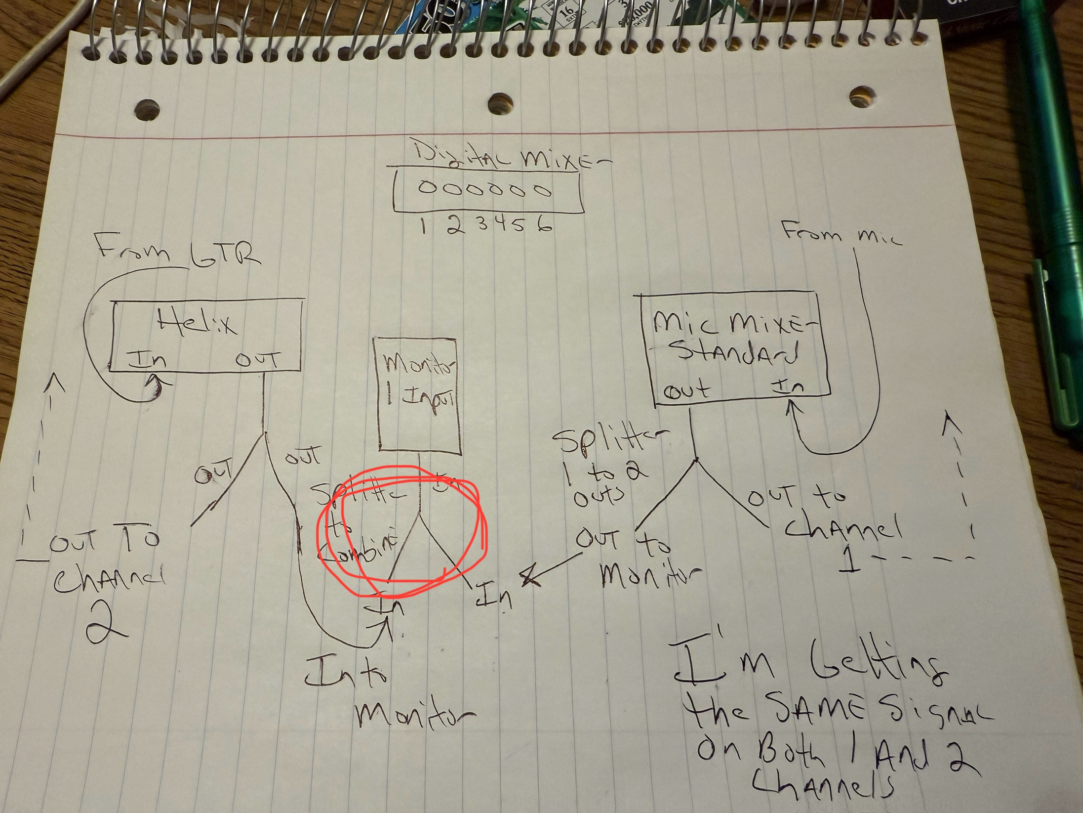

A diagram of how this is all connected would help. Specifically when you state the problem of you getting the combined signal. We need to see a path to venture a guess.
Here’s a diagram; hopefully this better explains my issue.
Thanks!!!
Your problem is that the signal(s) along my crudely made red line in essence is one signal. Since there is no active split both channel one and two on the big mixer get exactly the same input signal. The electrical signal will flow freely along all these cables. If you unhook either of the two inputs on the big mixer you should hear exactly the same combined sound.
You need a small two channel mixer for the monitor input in the middle of the drawing to actively split the signals from each other.
Something like this.
I have no experience with this device, but I would think it has to separate the two inputs from each other.
Your problem is this passive y-split. The little mixer would replace it.

Also “what you described” If you unhook either of the two inputs on the big mixer you should hear exactly the same combined sound.
IS EXACTLY WHAT’S HAPPENING!!!
